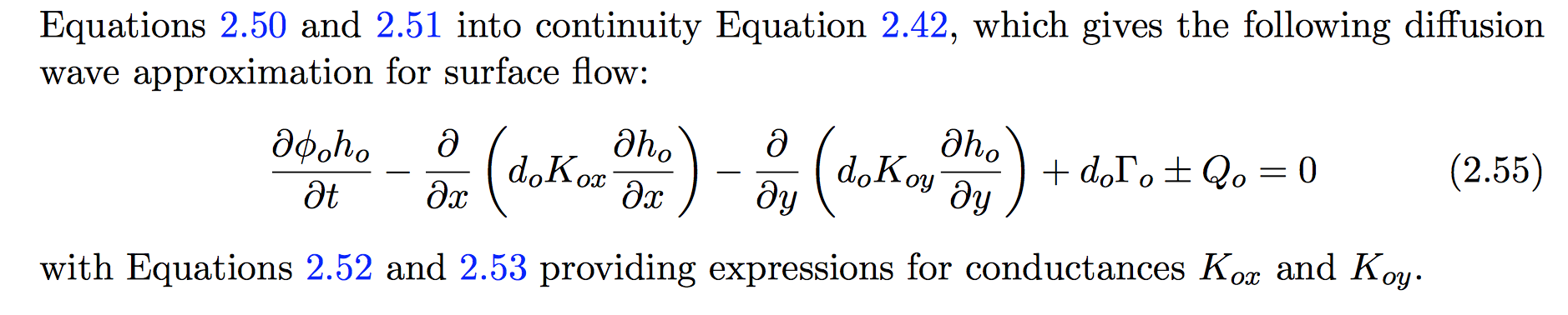

I want to write equation that I attached here, and I wrote it inside the comsol but I am not sure if this is the correct form of writing.
Explanation about equation: d0= depth of flow h0=water surface elevation K0(x,y)= surface conductance in x and y direction.

I tried to write 2D diffusive wave equation in PDE in comsol, but after running my program I confronted with this error:
Attempt to evaluate nonintegral power of negative number.
- Function: ^
Failed to evaluate variable.
- Variable: mod1.ksx
- Defined as: (mod1.d^0.66666666666666663)/((mod1.trueSlopex^0.5)*mod1.nx)
- Expression: d(d((-mod1.ut*test(mod1.u)-mod1.d*mod1.ksx*mod1.ux*test(mod1.ux)-mod1.d*mod1.ksy*mod1.uy*test(mod1.uy))*(dvol),{test@4}),mod1.ux)
