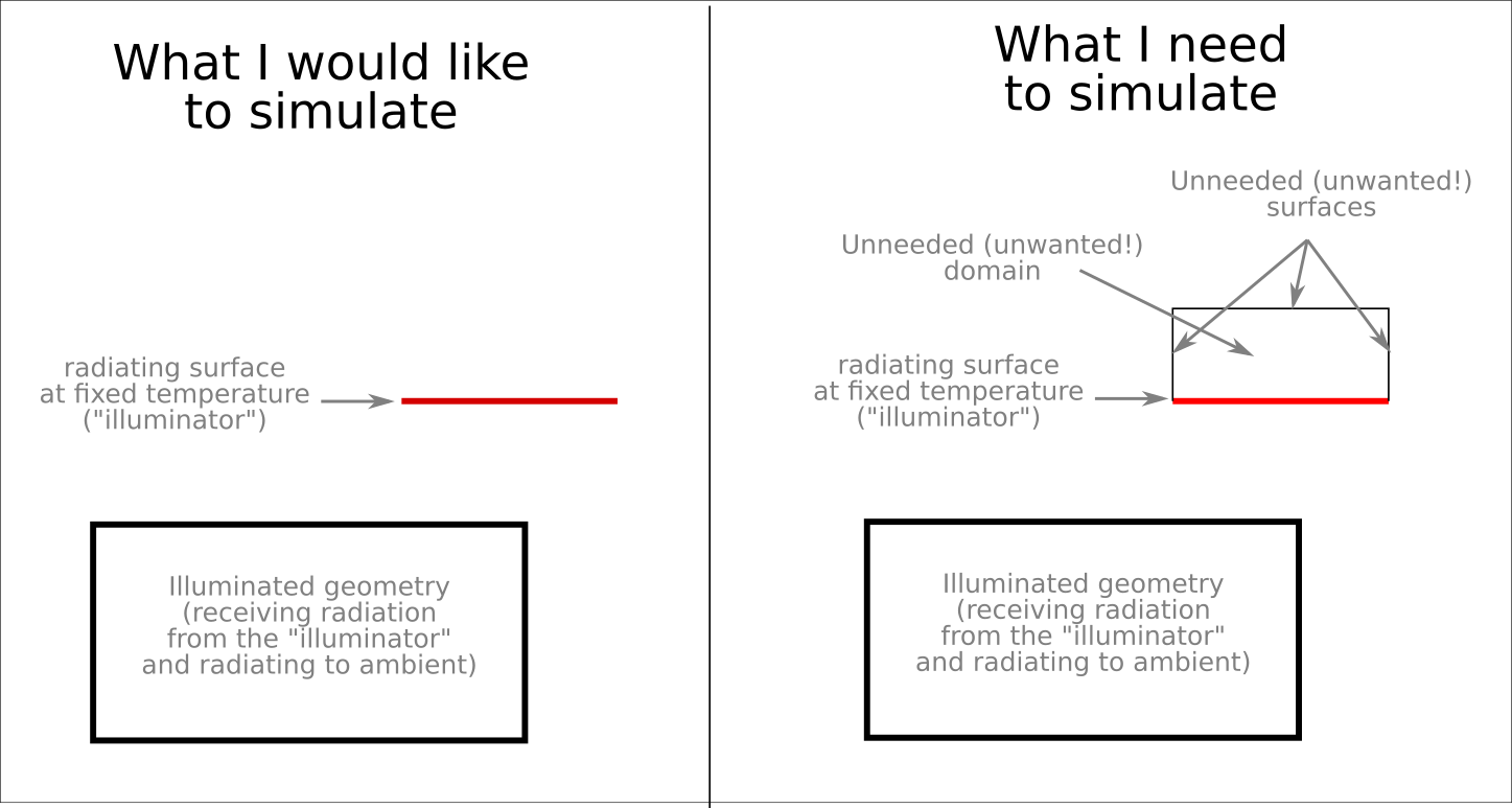

I need to define a radiating surface at fixed temperature that "illuminates" my model. I am not interested in how the heat gets to the surface, so I would like to avoid modeling a solid to "support" the surface, but I don't know hot to do it. In fact, if I model the surface as just a surface, I cannot include it in the Heat Transfer in Solids module, since it is not part of a domain.
Reasons to want to avoid modeling a solid:
- reduce complexity of the model
- not worry about radiating/shading effect of the other surfaces of the solid
While there are certainly workarounds to this issues (that can, however, get tricky in complicated geometries), it is the general principle that interests me. Is it possible to define a surface as a radiation source, without having a corresponding domain included in the heat transfer simulation?
Is this possible?

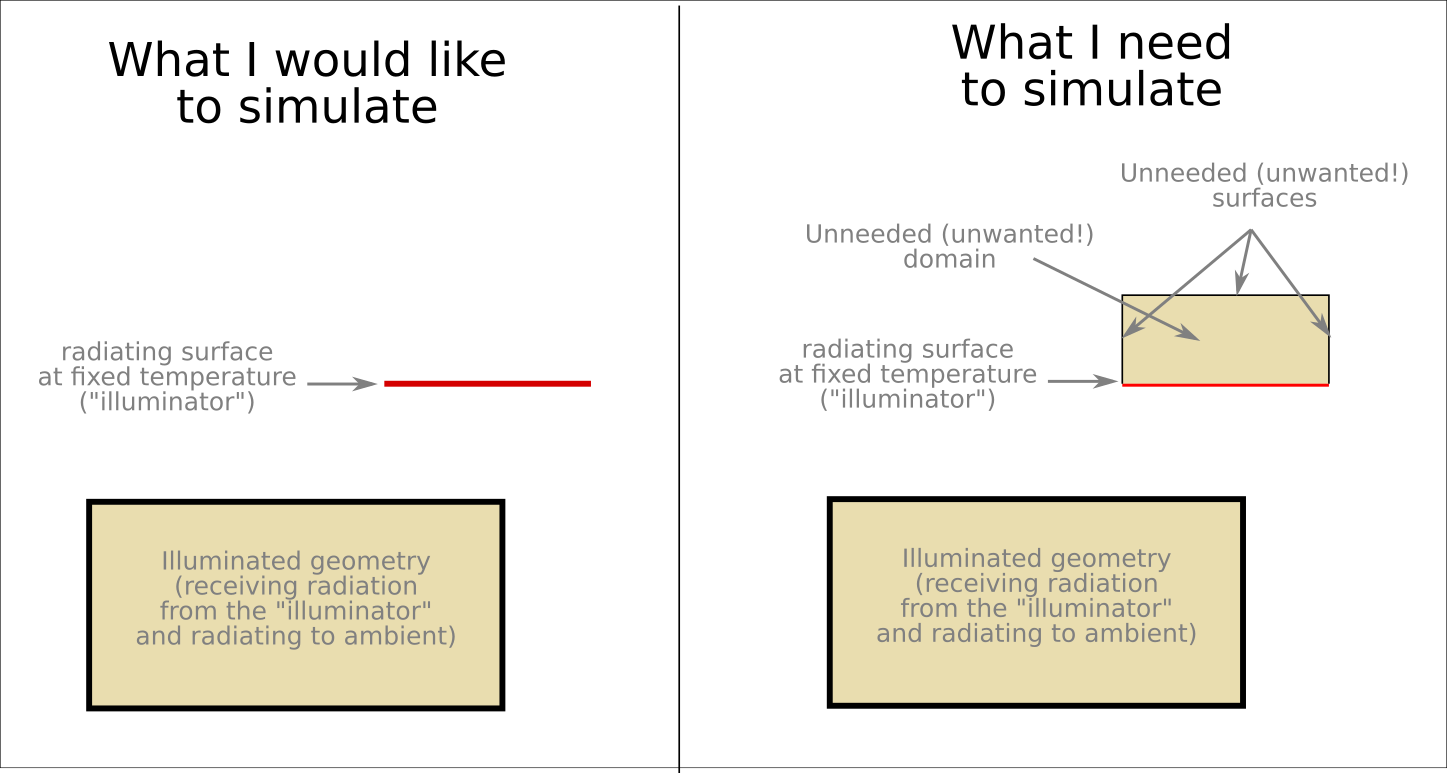

What I'm asking here is not a physical question, but a COMSOL one: suppose I have a geometry, and I want to calculate the heat distribution when I "illuminate" it with a uniform radiating surface of a specific size in a specific location. I can do this by adding to the model a box one of the face of which corresponds to my radiating surfaces. The problem is that now I have to deal with another 5 faces and a domain, that I don't need to (and actually would rather not have to) include in the simulation.
Rather than a COMSOL model, let me attach a picture illustrating the problem using an hypothetical simplified 2D model. Left is what I would like to obtain. Right is what I need to now, since I don't know how to include a radiating surface without it being part of a closed domain.
Hope this is clearer now.

Now again, the problem is: I have my domain representing the physical objects that are illuminated. I want to define a surface somewhere, at a fixed T>Tamb, that "illuminates" my object.
- If I create a domain (completely exterior to my illuminated objects, not "containing" them), then I can define one of its surfaces (looking towards the illuminated) as "emitting", and all works fine (see right panel on attached figure, in which I have colored the domain to make them easier to distinguish). However, I have the problem of having to include the additional domain, and its non-radiating faces, in the simulation.
- If I create just a surface, that would be ideal (left panel in the attached figure). Except, I do not know how to tell COMSOL to use that surface as a radiation source, since COMSOL only allows me to include domains, and not surfaces, in the "heat conduction" physics interface.
I hope it is now clear what my problem is...

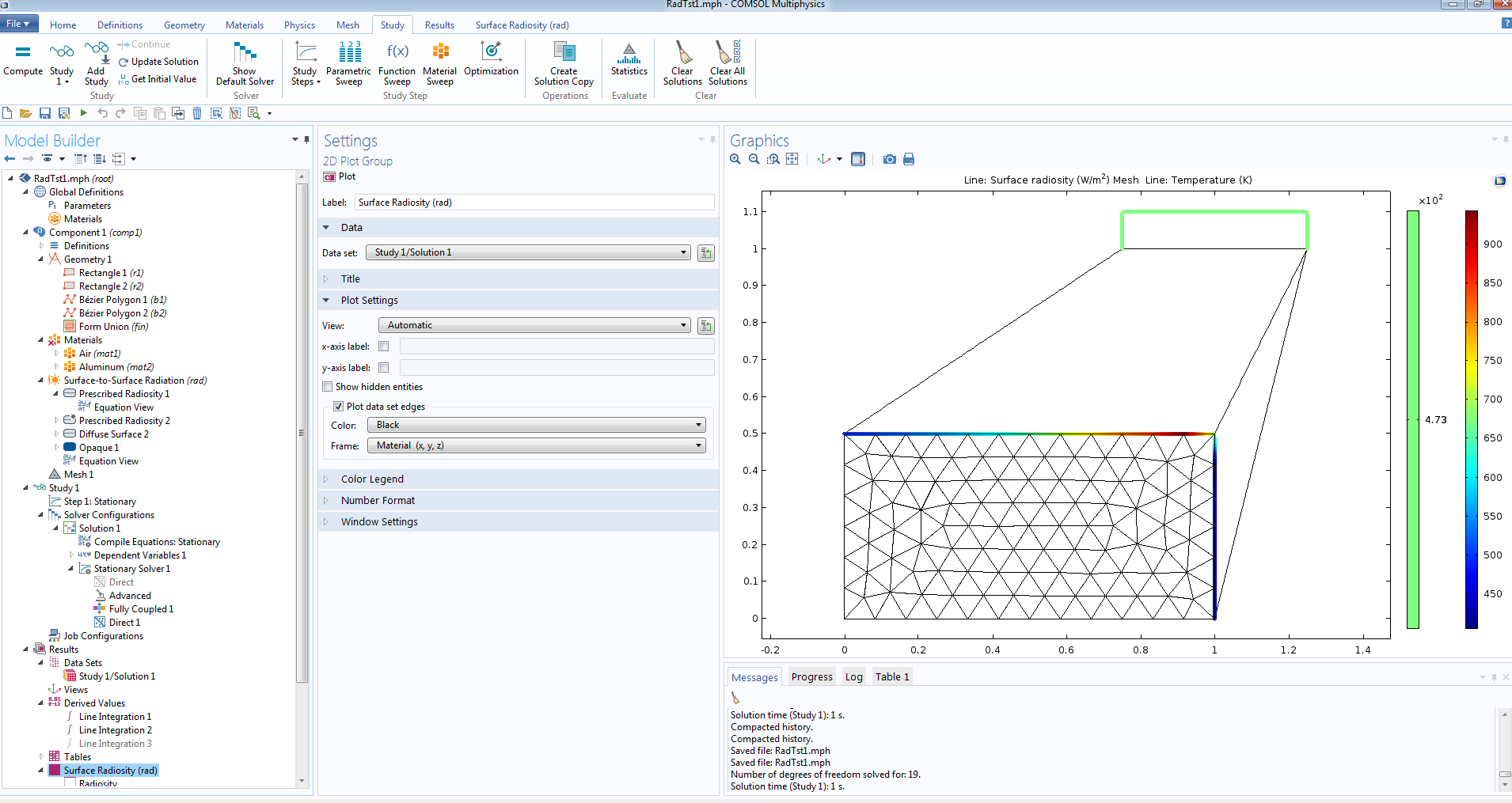

Posted: 1 decade ago 28 ago 2015, 03:08 GMT-4
Sorry for not understanding your issue at once, but there are so many possibilities ...
Probably what puzzles me is that what you are asking for is, for me, what the "Surface to Surface Radiation" module is exactly doing (or allows you to do)
I have tried to regenerate your problem in the model below in v5.1.0.180
check carefully the doc too, I see now that COMSOL has nicely improved the capabilities since I used it last :)
Here I'm not solving for an T, I impose them you need to add the HT for that (or use the full HT+Rad case

Unfortunately I cannot open the model you attached, as I'm limited to COMSOL 5.0. However, by looking at the screenshot, I do have a comment: I don't think you need to insert the two extra domains (triangle and trapezoid) besides the two rectangles.
Anyway, I think we are finally hitting the right spot. I am attaching two simple model files similar to yours (I should have done this from the beginning):
