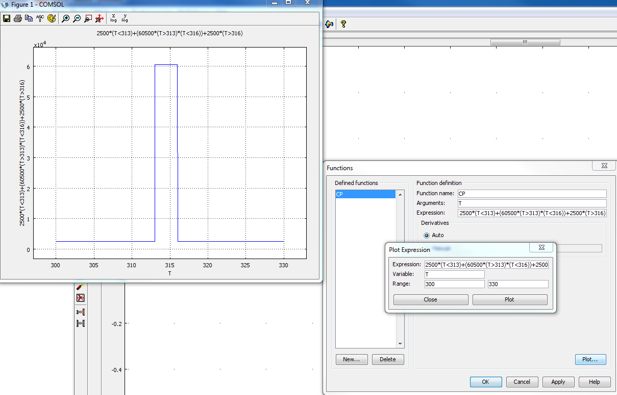

I have a material that change phase from 313 to 316 K. The melting cp is 60.5 kJ/kgK and the cp from solid state is 2.5 kJ/kgK, and I type this into the program
Cp= 2500*(T<313)+(60500*(T>313)*(T<316))+2500*(T>316)
It works, but now i would like to plot the function in order to check the latent heat, if the integral of that cp function is the latent heat of my material i could validate the formula. My model is in 2D in COMSOL 3.5a.
I hope I've been clear,
thank you so much.
