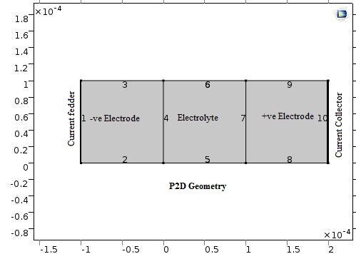

I am a research scholar from India and my research is based on two physics Li-ion and Magnetic field. Sir, I need your kind help to understand about Magnetic field. My problem is how to applied magnetic field with Li-ion battery that magnetic field would be relate to li-ion battery during charging and discharging time. I have applied as shown in figure attached but not getting desirable results. I have applied external magnetic field to boundaries 3, 6, 9 and want to measure the change due to li-ion battery at boundaries 2, 5, 8. However, when I applied the same and it would not change with discharging time. It is constant for whole the time. Please help me and I am sorry for poor writing skills. Thanking you with warm regards.
