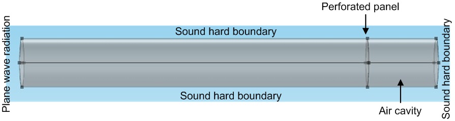

I am trying to model a perforated panel in impedance tube.
Posted 15 ago 2015, 02:06 GMT-4 Modeling Tools & Definitions 1 Reply
My name is Hwa Young, Song, I'm a Korea student in acoustics (from seoul national university of science and technology)
I am trying to model a perforated panel in impedance tube. (refer to attached file).
But i have the problems with the absorption coefficient(alpha) and reflection coefficient(R).

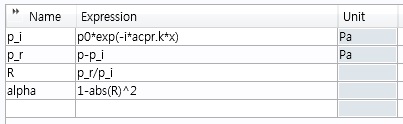

I have defined the variables in below
p_i : 1[Pa]*exp(-i*acpr.k*x)
p_r : p - p_i
R : p_r / p_i
alpha : 1-abs(R)^2
But my results don't look like as absorption coefficient
I also tried different variables and i still got different results..
Could someone check the correct variables?
and did someone tried something similar and help me?
