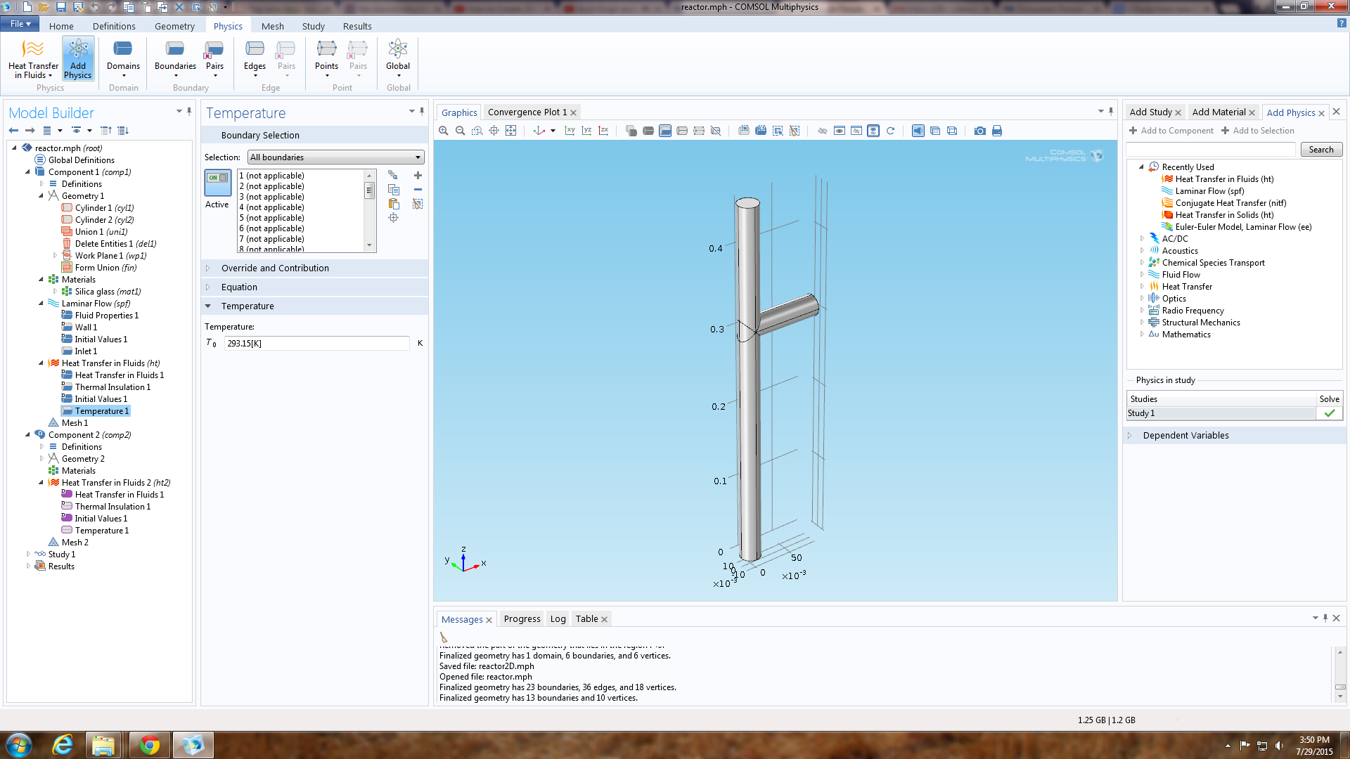

I have joined two 3D pipes resulting in a T shaped joint. Now i am not able select boundary for assigning temperature and velocity.
Please find the attached screenshot.

Please go to "Heat Transfer in Fluids" and make sure the pipe domain is selected for that physics.
