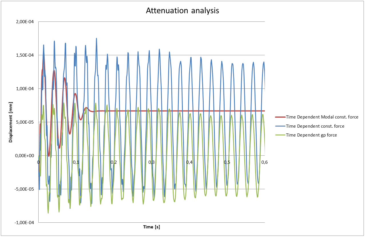

Below is an image of the 3 options which I could already simulate
- Time Dependent Modal const. force of 1[N] (a damping is very easy to recognize)
- Time Dependent const. force (no damping can recognize, but a shift/offset by the constant force)
- Time Dependent gp force (gp: Gaussian Pulse, a shift by the constant force was avoided but still no damping can recognize)
cya Thomas

Hi Thomas,
That is an interesting problem. The way your model is set up you should not be getting any damping! The damping you get in the modal analysis Study is because of low convergence tolerances that lead COMSOL to take a big enough step size that causes NUMERICAL damping. If you reduce the convergence tolerances you will get less of that numerical damping.
To get more physically accurate damping you need to add damping ratios to the modal analysis. For the non-modal analysis you can use Rayleigh damping, or a material model that has built in damping, such as viscoelastic.

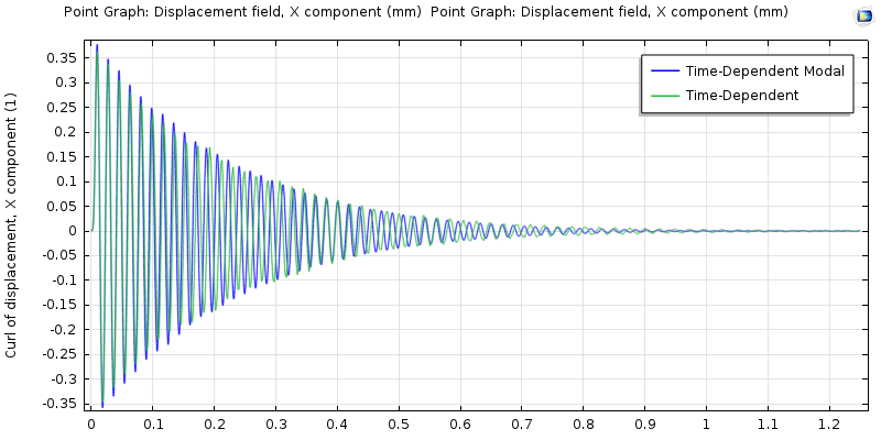

Posted: 1 decade ago 29 lug 2015, 05:01 GMT-4
Additionally I have added damping (random value for a first try, Linear Elastic Material 1-> Damping 1).
In Study 1 I used a constant force of 1 [N] (Boundary Load const. force and deactivated Boundary Load gp force) and at the solver (Modal Solver 1) i used a Load factor "an1(t[1/s])" (gaussian impuls)
and in Study 3 i used the gaussian impuls Boundary Load gp force and i have deactivated Boundary Load const. force.
The result already looks very good, I just have to find the right damping factor and eliminate the phase shift of both simulations

Hi Thomas, you’re welcome! The phase shift you observed may be a result of the numerical integration in the non-modal transient analysis. Basically time integration not just introduces some numerical damping, it also introduces a phase lag that results in a reduction in frequency! Both effects decrease as the time step size is reduced. I tried briefly to reduce the step size but could not eliminate that phase lag, so there may be another reason behind it for this problem.
I have a comment on the two displacement curves you plotted though (modal and non-modal). They involve a half-cycle phase shift over a period of 13 cycles, and the peak displacement amplitudes are very similar. For many dynamic applications that level of accuracy is good enough.

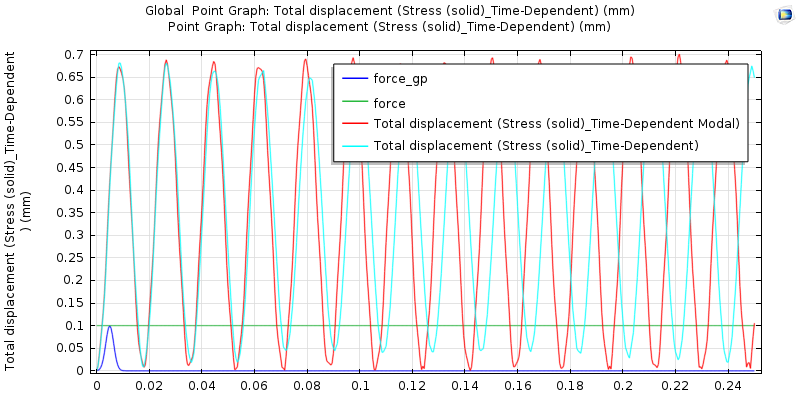

Posted: 1 decade ago 30 lug 2015, 02:36 GMT-4
there is a bit more to say here:
first of all you are using 5.0, while I get an error message in my 5.1.0.180:
Time-dependent equation residual vector is not supported for modal analysis.
==> update this is "simply" that the TIM solver does not accept a "time dependent load" only a constant time INdependent load !
So I cannot run the modal solver, even if I define a new Solver. This is new to me so I'll have to dig further here, so I cannot compare the values of your latest model
Second I see that your time dependent analysis (study 3) is done in "free" time stepping and that from the log you are interpolating many results between true solver steps, for oscillatory models like this you should rather use the "intermediate" time stepping to ensure that the solver takes one time step in-between each saved result.
I see also you select all 6 modes, while the two last Twist Theta_Z and Elongation/compression Dz at 379 and 614 Hz respectively will not be much excited, so the time stepping at 5E-4 s or 2kHz should resolve adequately the 4 first modes (even the 6) if the solver steps for each. This takes some more time to get to the solution, but still it's reasonable.
I suspect (and see from my comparison) that your solver-relative phase delay also comes from the time dependent solver settings!
You could check further by taking an FFT of the resulting oscillations, there are operators to do this inside COMSOL, even if it has disappeared from the Derived Values - Data Series Operation, it's now a solver process you can add to the time stepping solver (see the doc FFT Solver)

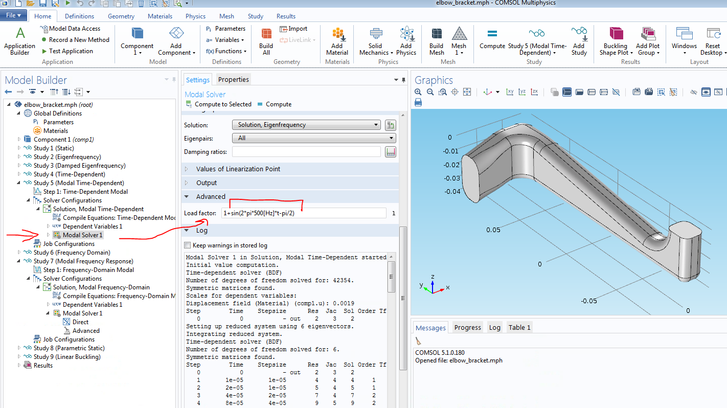

Ivar, good point. The Time-Dependent Modal solver appears to only work with time-independent loads which is quite restrictive. It turns out that it can work with time varying loads but that feature is quite hidden in my opinion! COMSOL should highlight it better, and maybe mention it also in one of the Tutorial examples.
You have to remove the time-dependent factor from the load definition(s) and add it to the Modal Solver > Advanced > Load Factor. It still means that you can only have one time dependent factor for all loads in the model but in many cases, such as this problem, that is sufficient.

UPDATE:
You can find the example for the time domain in the Application Library "elbow_bracket.mph" example but you must dig all the way down and open the "Advanced" tab of the Modal 1 Solver node.

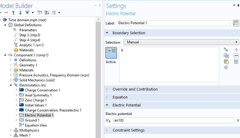

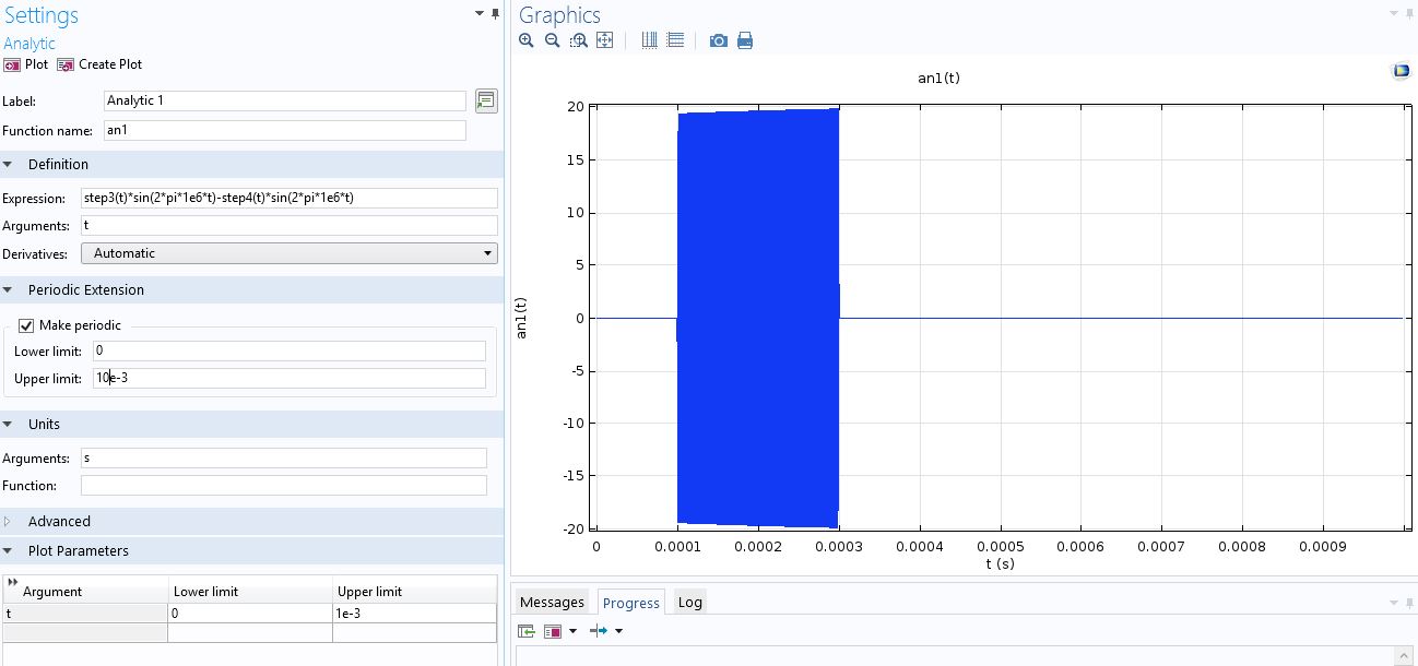

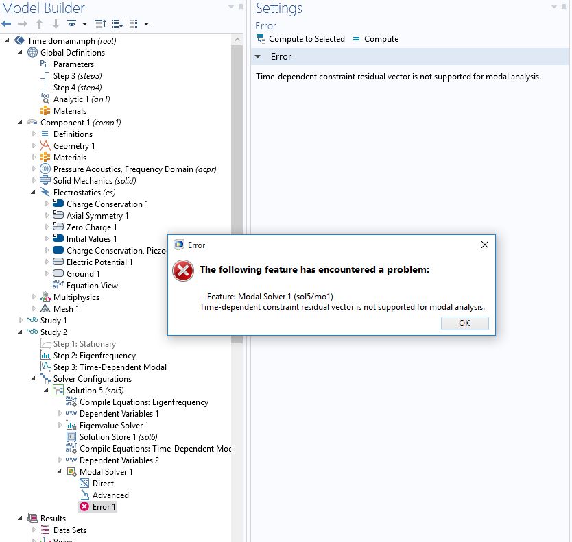

I am using Comsol 5.3 and trying to model a piezoelectric transducer. I have defined an analytic function as figure 1. I want to load the piezoelectric voltage with this pulse so I added it to the electric potential as shown in figure 2.
When I run the time-dependent study, I get the error that is shown in figure 3. I have tried to add "an1(t)" to Modal Solver > Advanced > Load Factor, but it did not work.
What is this error message implying to?
