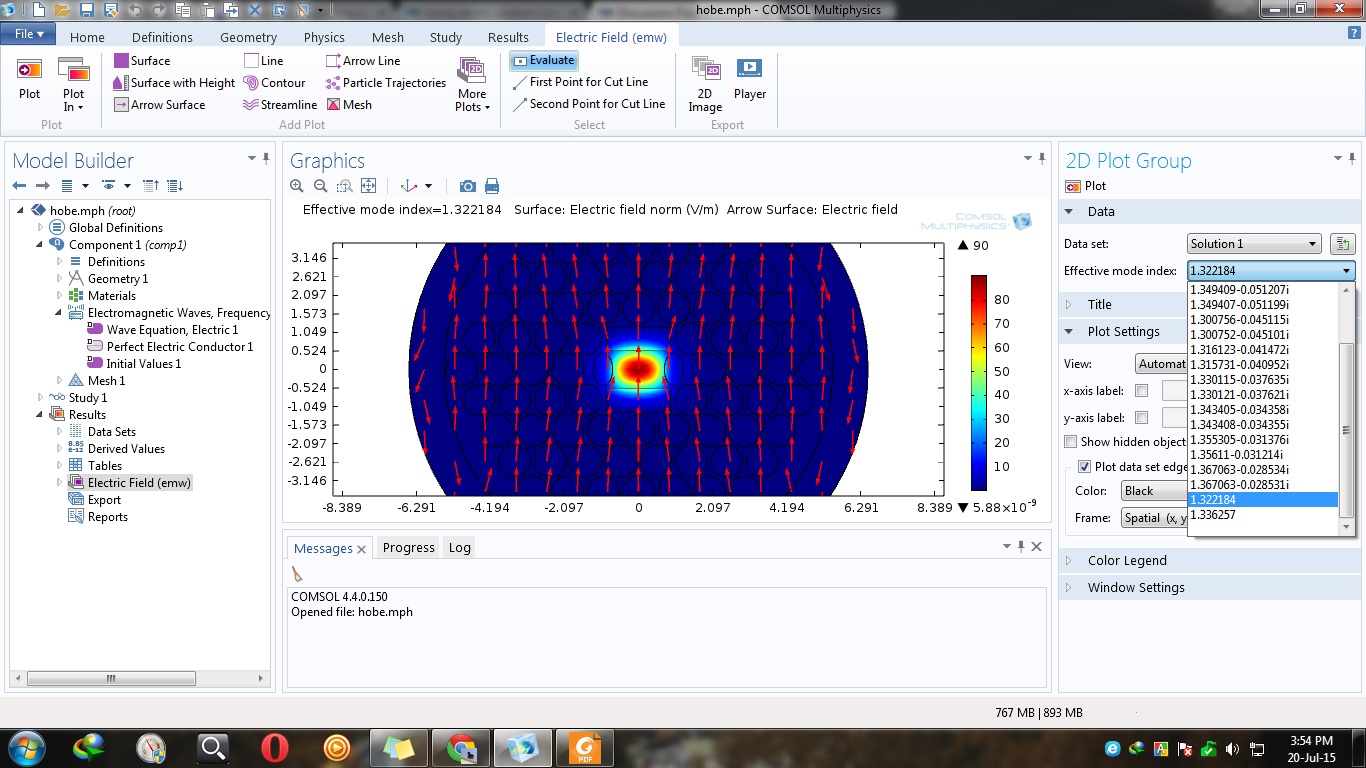

Effective index imaginary part doesn't appear.
I am trying to measure the confinement loss in a photonic crystal fiber using the fundamental mode effective index. for a wavelength 1.55um and upwards, the fundamental mode has an inedx of 1.270578-1.825e-10i , which means I could calculate the confinement loss from the imaginary part. But for any smaller wavelength, the effective index of fundamental mode becomes real. It seems like COMSOL isn't calculating imaginary part below e-10i range.
Any solution to this problem ?

Hi, have you solved this problem, I also have this issues, it would be nice to get your advice.
Thanks.
Hi, have you solved this problem, I also have this issues, it would be nice to get your advice. Thanks.
Posted: 10 years ago 28 mar 2016, 14:52 GMT-4
Yes, later i found that the imaginary part in fact existed, but it was too small for COMSOL to calculate. anything below 10^-9 doesn't seem to appear in comsol. Change the deciding parameters like wavelength and you'll see the imaginary part starts to appear after a certain increase or decrease of the parameter.
