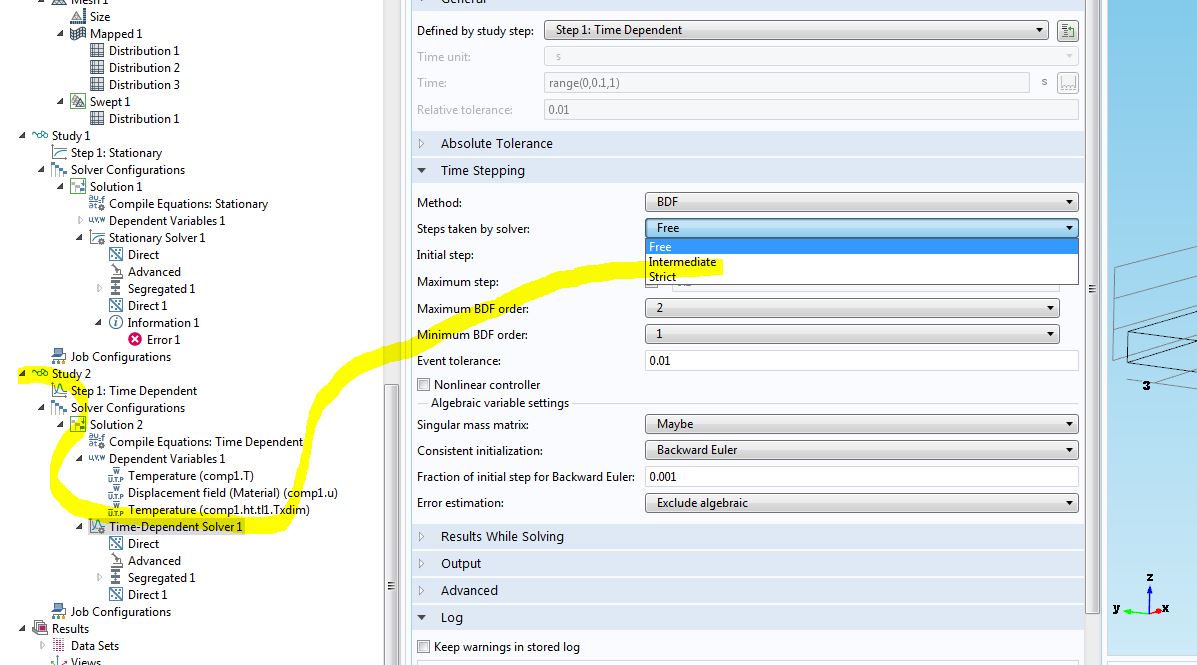

I see two possibilities:
a) either you have a very special geometrical shape and material properties
but far more likely
b) your time stepper is in "free" mode and the internal solver algorithm is aliasing your time dependent sinus waveform
Use the Time stepping "Intermediate" settings and ensure you have mat least 5 time step per sinus period

Thanks Ivar!
It works, I got the sine wave thermal signal by changing the time stepper!!
Thanks Ivar! It works, I got the sine wave thermal signal by changing the time stepper!!
