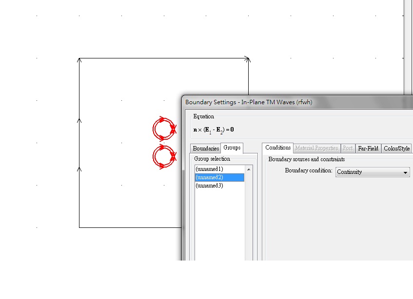

HI,dear comsolers:
I'm a new player in comsol(3.5a). I want to ask a simple question?
Firstly, In RF Module => In-Plane Waves=> TM waves

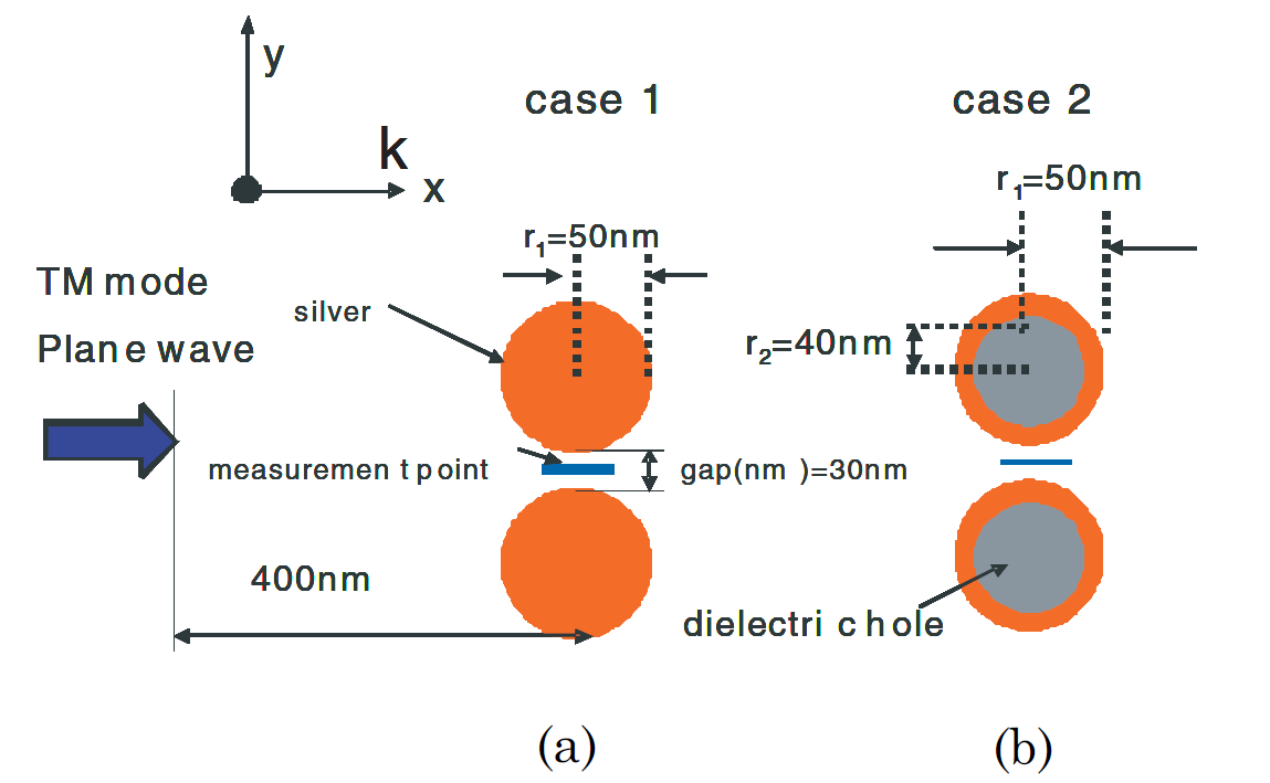

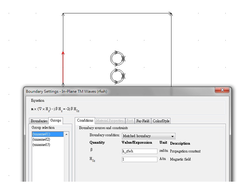

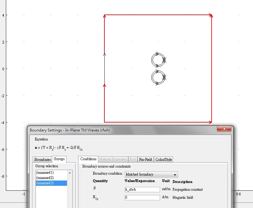

I want to set a quadrilateral of the environment. If the plane waves come fromm the left side,
then how to define the In plane wave by using boundary setting?
and how to define the other three sides also by using boundary settings ?
do everyone think what I do in comsol ?
Secondly, what is meaning of the " matched boundary " and how this condition can use ?
see the file
Thank you, everyone
