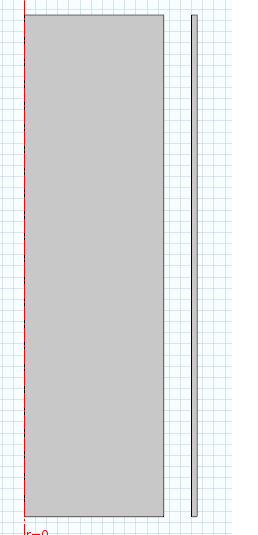

I am modeling a radiation shield for a resistojet thruster (spacecraft engine), I have attached a sketch of the study.
The first rectangle is the thruster and the second is the radiation shield, between the 2 rectangles, the heat is transferred only by radiation.
When I am using the surface-to-surface radiation, I need to give a value for Tamb.
In this case does Tamb=T?
Thank you.
