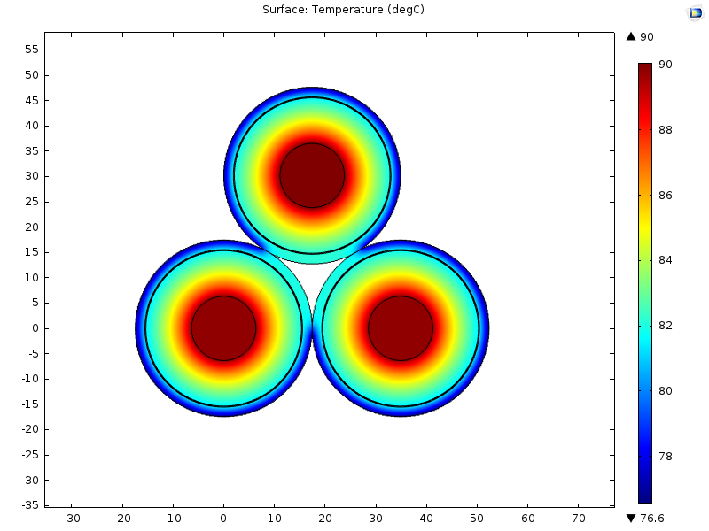

I am working on COMSOL simulation with joule heating to get current throw a cable
i made the model and it is work well assuming heat source Q (W/m3) value in heat transfer throw cooper conductor insulated and from this heat source i make analogy to get the current
But when i try to assume current source or current density instated of heat source model failed
I need to assume a current throw the conductor and solve the heat transfer in solid base on it to check temperature around each layer
Any one have ideas or can help
