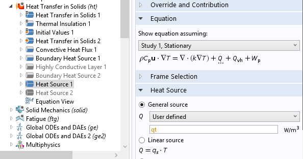

I try to model heat transfer with time derivative heat source Q=dq/dt, with q=Qm*exp(Tau/t)^(Beta)
Qm, Tau, Beta are constant.
Are there anyone know how write dQ/dt in COMSOL?
I have tried either qt or d(Qm*exp(Tau/t)^(Beta),t) but both of them doesn't work.
I got the following error:
Failed to evaluate variable Jacobian.
- Variable: qt
- Geometry: 1
- Domain: 1
- Feature: Time-Dependent Solver 1 (sol1/t1)
