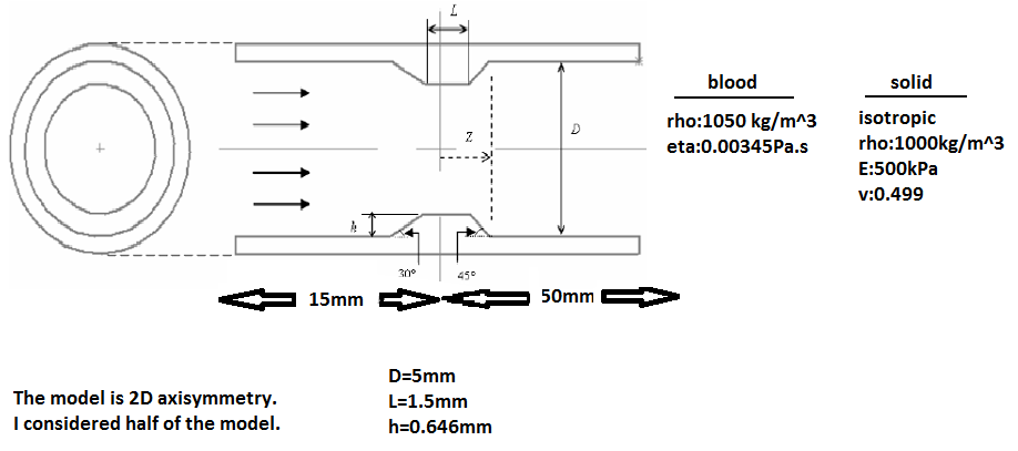

My model is a 3Dcylinder with a thickness(the walls are the solid domain and inside the cylinder is fluid domain where the fluid flows). The inlet boundary is a sin function(0.219+0.132sin(18.2t)),I wrote this in scalar experession and then used it in the inlet>laminar velocity boundary.The outlet is pressure outlet(4140pa).I chose the MEMS module>Fluid-structure interaction>solid,stress-strain..>transient to consider fsi..but my model didnot converge..I solved it before with anouther inlet velocity function(U^2/*(sqrt(t^4)+0.07t^2+0.0016) with no problem.
Does anyone know where is my problem?it may be at defining the sin inlet function!?how can I solve it?

Danial my model, that is an article work(they worked with ansys) and I want to validate this model with comsol and then go to my own model, is attached.The boundary conditions are
inlet: velocity(.219+.132sin(18.2t))
outlet:pressure outlet(4140pa)
when I couldnt get result with this,I switched to a simple cylinder because I guessed that the problem may be because of inverting mech in the stenosis region.
but even in cylinder it didnt solved.
I changed the velocity function to [(U^2/sqrt(t^4-.07t^2)+.0016 and U=.033m/s]and pressure outlet to zero and it converges.but these changes are just to find the problem!!(indeed I didnt)
you know I think It is because Im not good familiar with comsol.
I need your help to continue please...
