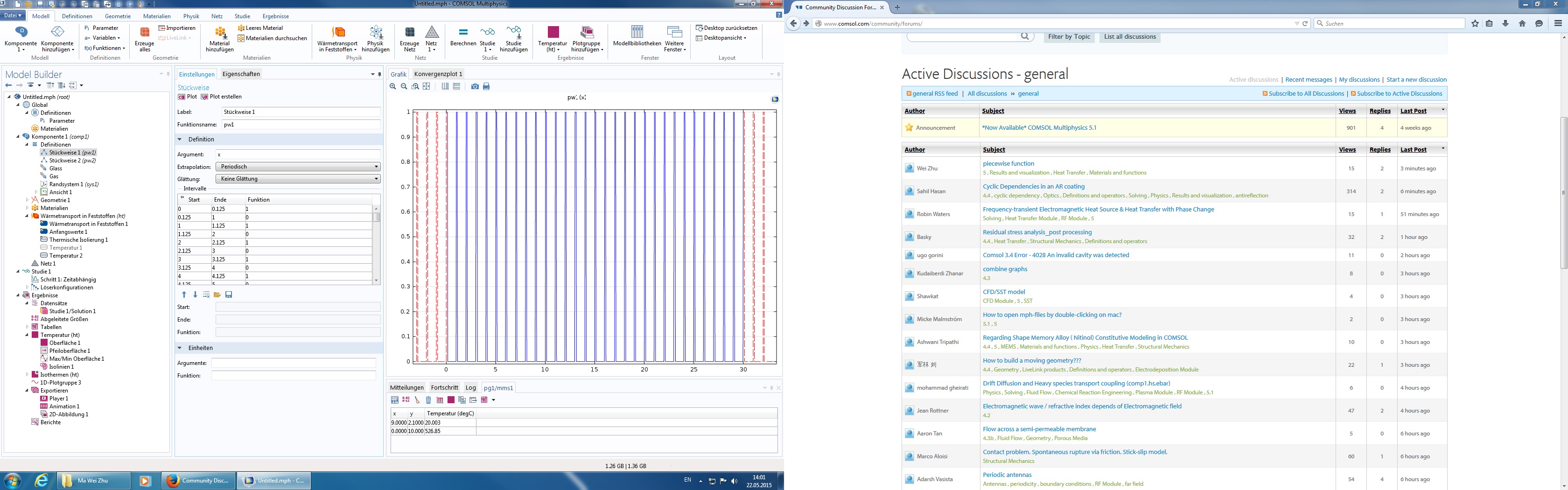

Thanks for you answer. But I still have a question. How to understand that the time not coincide with the stepwise function? Because at first period, the result at 0 to 0.125s is correctly 1, but after that, the result of function is always 0. I'm sure that the stepwise function is correct, because I have also seen the waveform, every second it has a high value.

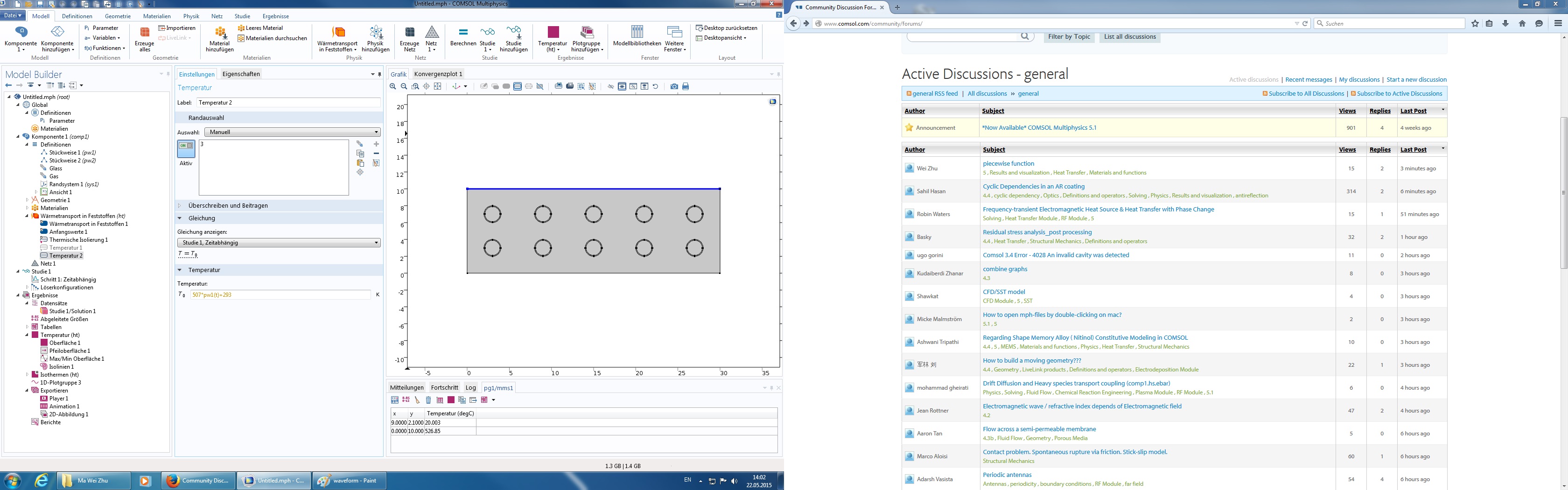

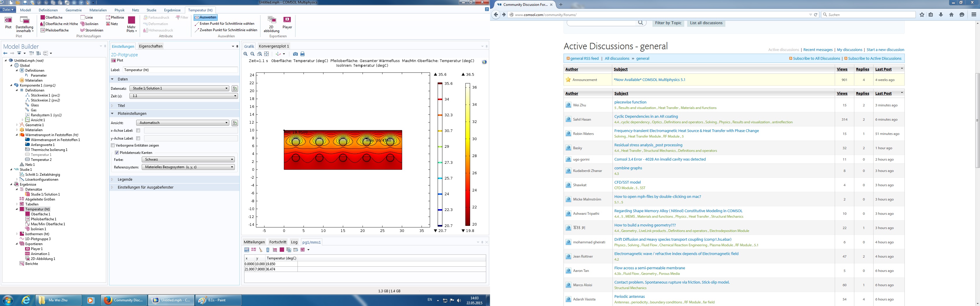

Thanks Lasse. I have upload some pictures about the waveform, the temperature, temperature distribution at 0.1s, at 1.1s. So the problem is the temperature at 1.1s.

Do you still have argument name x, as in your jpg-image?
