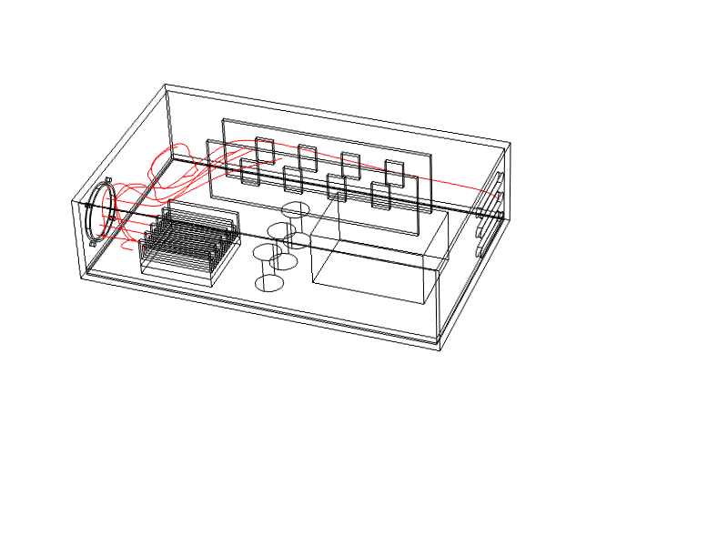

I have attached a screenshot of the situation. The fluid volume (air) fills all of the enclosure
and this is what I get for 20 startpoint-controlled streamlines.
Best Markus

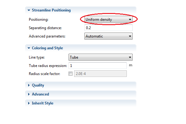

Try another positioning method "Uniform density" and chose an appropriate "Separating distance" (see attached figure).
Zoran
Interesting. What are your settings of streamline? Try another positioning method "Uniform density" and chose an appropriate "Separating distance" (see attached figure). Zoran

thanks again for your quick reply.
I have tried the "seperating distance" and it gives somewhat less awkward results but still looks strange.

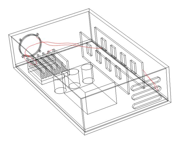

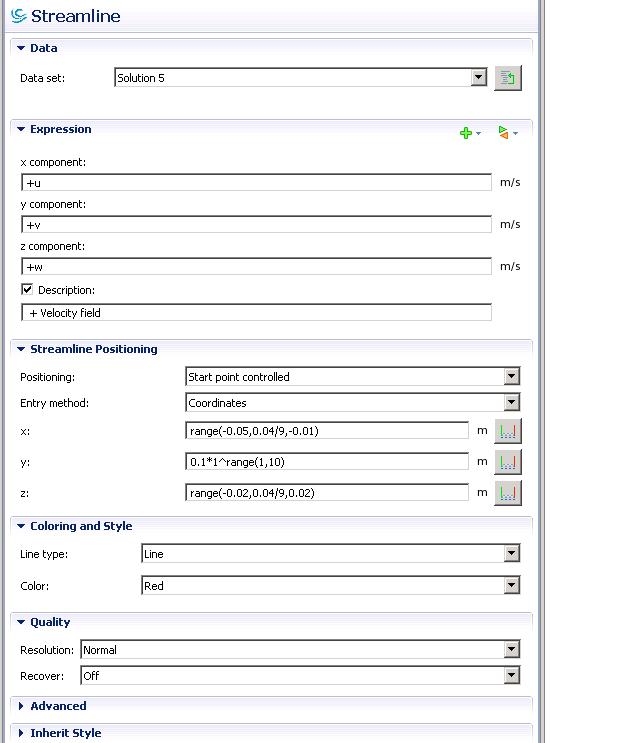

If I try to start the streamlines from a useful location (e.g. some inlet boundary) using coordinate
ranges, neither the number of resulting lines nor the starting coords seem to be correct. (See pics)
BTW: This is already 4.0.0.933
Best
Markus
Hi, thanks again for your quick reply. I have tried the "seperating distance" and it gives somewhat less awkward results but still looks strange. If I try to start the streamlines from a useful location (e.g. some inlet boundary) using coordinate ranges, neither the number of resulting lines nor the starting coords seem to be correct. (See pics) BTW: This is already 4.0.0.933 Best Markus
