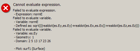

Excellent, this is exactly what I was looking for. But there is still a problem. If I use the variable (dubbed normE) as a plot expression I get an error "failed to evaluate variable" a screenshot of the error message dialog is attached. If I replace "normE" by "sqrt(realdot(es.Ex,es.Ex)+realdot(es.Ey,es.Ey)+realdot(es.Ez,es.Ez))" in the expression field the plot works without error.
Another thing is maybe unimportant but still... if I define an expression in a plot then comsol automatically computes the corresponding unity (V/m etc.). But when I define a Variable under "global definitions" it doesn't. Is this a hint that it doesn't recognize the names (es.Ez etc.) used in defining the variable?
Too bad that comsol does not allow the grouping of user-defined vector component variables. This would be a fine feature to add.
Regarding the error, my guess is that you have defined the variable as a global variable under Global Definitions instead of a local (to the active model) variable under, for example, Model 1>Definitions. It is possible, but then you need the syntax mod1.es.Ex etc. to access these quantities.
