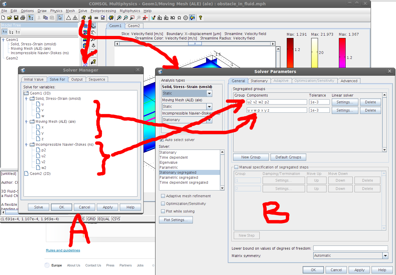

Check the variables you're solving in the solver manager. Now, you have to list them all in the segregated solver manager, or it will give that error. Pay special attention to the lagrange multipliers (lm3,...). Also, please keep in mind that obstacle in the flow is a weakly coupled FSI problem (and not a two way strongly coupled FSI) in Comsol 3.5a AFAIK and remember.

Look at the A window. Every variable there is listed in the B window. Don't miss any of them. You may see some lm3, lm4, ... when you enable the weak formulation. You should add them as well to the B side.
[QUOTE] salam Im very thankful for your discription.. Danial Im using version 3.5.Would you please tell me how to make changes to remove that error? Its your kindness. maral [/QUOTE] Look at the A window. Every variable there is listed in the B window. Don't miss any of them. You may see some lm3, lm4, ... when you enable the weak formulation. You should add them as well to the B side.
