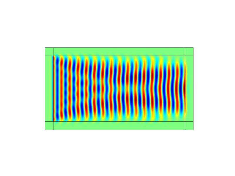

I can create ideal plane wave by setting perodice conditions on the top and bottom boundary. Left bondary is the magnetic field(set Hz=1), right boundary is the Perfect matched layer.
However, if I use the same geometry and configuration of boundary conditions, it would not create an cylinder diffraction pattern. It seems to create cylinder array diffraction pattern.

The attached is my mph file. I put PML around the simulation domain.
As shown in the simulated results, the simulated TM plane wave is not perfect. The plane wave on the top and bottom boundary is not so good.
Do you have any suggestion?

The the boundaries you set are not symmetry, so the result should as it is.

I double check my model. I just put PML around the simulated area. And on the inner edge of the left PML boundary, I put the magnetic field condition(Hz=1). It is not symmetric?

The proper way of introducing incoming wave is to use scattering boundary condition and there specify your magnetic/electric field. In this case, it will be a 'soft-source' meaning it won't automatically repel your backscattered light. However, in Comsol, scattering boundaries can be placed only at the exterior of geometry limiting their applicability for excitation of a soft source. If possible, I would suggest you to use the application mode dedicated to scattering problems, if you are not using already, and use the field of incident wave to define excitation source. This makes it possible to surround your entire geometry with PML and excite a 'soft-source' as well. In 3.5a, we find it in physical properties menu.

Rest, you got me quite right actually. Just to add to what I said before, Scattering boundary is perfect for absorbing only reflected plane waves so in some cases it might not be the best choice. And besides scattering boundary, you could also used matched boundary and port boundary conditions (again at exterior of geometry) but both of them are suitable to launch eigen modes in waveguides.
Anyhow, I am attaching a tutorial model which computes scattered field from a dielectric object. I don't where in 4.0 the distinction between simple harmonic and scattered harmonic analysis sets in, but in 3.5a it is defined in "Physics->Properties->Field type". At the moment it is set to scattered TE which is why we have the luxury of having incident field whilst the whole geometry is enveloped by PMLs. Otherwise, and this is to the best of my knowledge, if the option of TE/TM/Hybrid waves is selected then we will have to specify one of the exterior boundaries for incoming wave leaving that facet out of the cover of PMLs.
