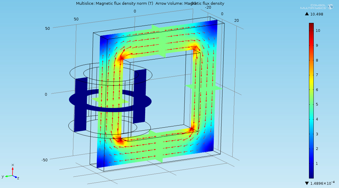

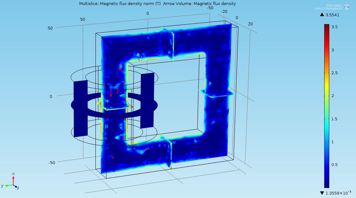

Posted: 1 decade ago 8 mag 2015, 11:09 CEST
Dear Dima,
I would like to ask you something regarding your model:
1) how do you take into account the fact that your core is missing a certain percentage of magnetic material?
I mean, if laminated, the core will be made of layer of metal and insulator, henche the core will have a magnetic material volume smaller than 100% of the yoke volume. This can be described by a filling factor usually, but I don't know how to set it i comsol.
2) I use single coil turn with an inner surface as gap feed. There are advantages in using the multi turn coil, as you did?
Francesco
Dear Dima, I would like to ask you something regarding your model: 1) how do you take into account the fact that your core is missing a certain percentage of magnetic material? I mean, if laminated, the core will be made of layer of metal and insulator, henche the core will have a magnetic material volume smaller than 100% of the yoke volume. This can be described by a filling factor usually, but I don't know how to set it i comsol. 2) I use single coil turn with an inner surface as gap feed. There are advantages in using the multi turn coil, as you did? Thanks Francesco
Posted: 1 decade ago 11 mag 2015, 06:55 CEST
Hi Francesco,
1. The attached model was just an example of how to use material conductivity settings in order to prevent undesired eddy currents in the core. There is no (as far as i know) straightforward way to define core filling factor. You can reduce core permeability (depends on the permeability settings you use) in order to get the desired flux.
2. Sure, any type of coil and excitation can be used. Multi-turn coil was used just for the example.
Best Regards,
Dima.
Dima Apter
A2Z Consulting Ltd.
www.a2z-consulting.com
Hi Francesco, 1. The attached model was just an example of how to use material conductivity settings in order to prevent undesired eddy currents in the core. There is no (as far as i know) straightforward way to define core filling factor. You can reduce core permeability (depends on the permeability settings you use) in order to get the desired flux. 2. Sure, any type of coil and excitation can be used. Multi-turn coil was used just for the example. Best Regards, Dima. -- Dima Apter A2Z Consulting Ltd. www.a2z-consulting.com
