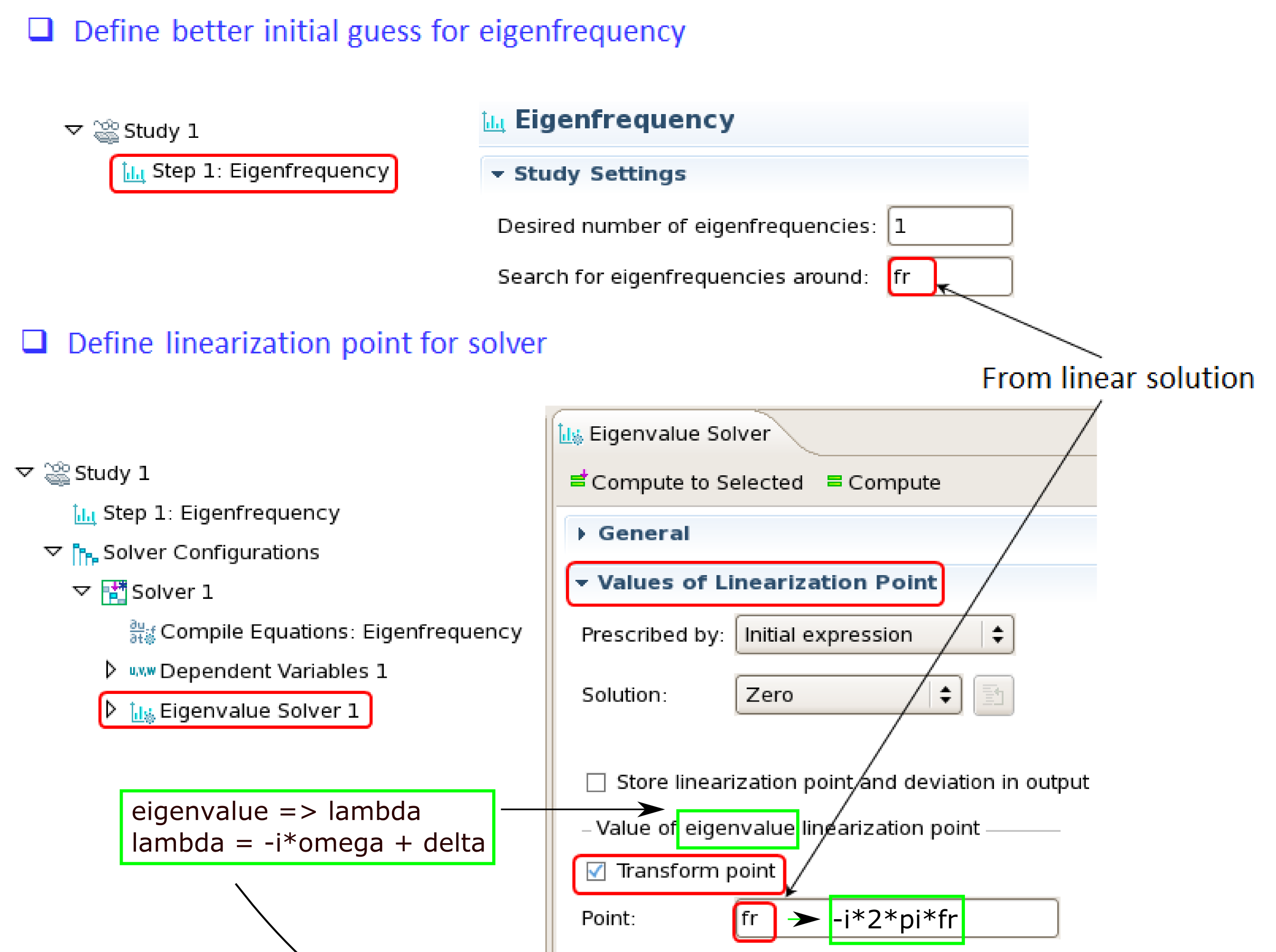

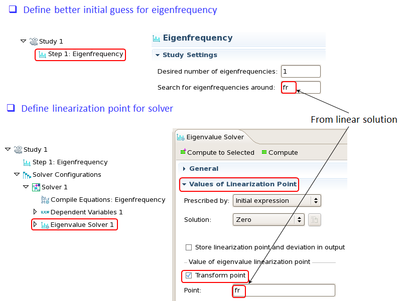

Posted: 1 decade ago 1 mag 2015, 12:24 CEST
Thanks a lot Sergei ! Now I got expected results )
It works perfectly for version 4 and latter.
For version 3.5 it works a little bit diffrent , when entering 'Transform point' not frequency but eigenvalue should be entered (see attachment).
If somebody else experience the same difficulties i found this www.comsol.com/model/lossy-circular-waveguide-1418 to be very useful.
Thanks a lot Sergei ! Now I got expected results ) It works perfectly for version 4 and latter. For version 3.5 it works a little bit diffrent , when entering 'Transform point' not frequency but eigenvalue should be entered (see attachment). If somebody else experience the same difficulties i found this http://www.comsol.com/model/lossy-circular-waveguide-1418 to be very useful.
