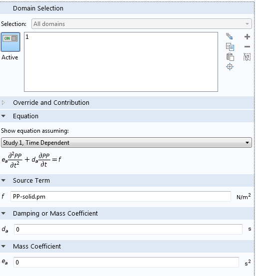

Last time you mentioned I can create a Domain ODE/DAE, with a single variable, say PP that you assign equal to the pressure, solid.pm. Now, in the Domain ODE/DAE, I set the source term as "PP-solid.pm" and set damping and mass coefficient as zero, as shown in Fig.
It seems there is a relatively large error between PP and solid.pm,especially at the boundary or interface. I am so confused about it. Did I miss something? Thanks!
Rong
Hi, Last time you mentioned I can create a Domain ODE/DAE, with a single variable, say PP that you assign equal to the pressure, solid.pm. Now, in the Domain ODE/DAE, I set the source term as "PP-solid.pm" and set damping and mass coefficient as zero, as shown in Fig. It seems there is a relatively large error between PP and solid.pm,especially at the boundary or interface. I am so confused about it. Did I miss something? Thanks! Best, Rong
