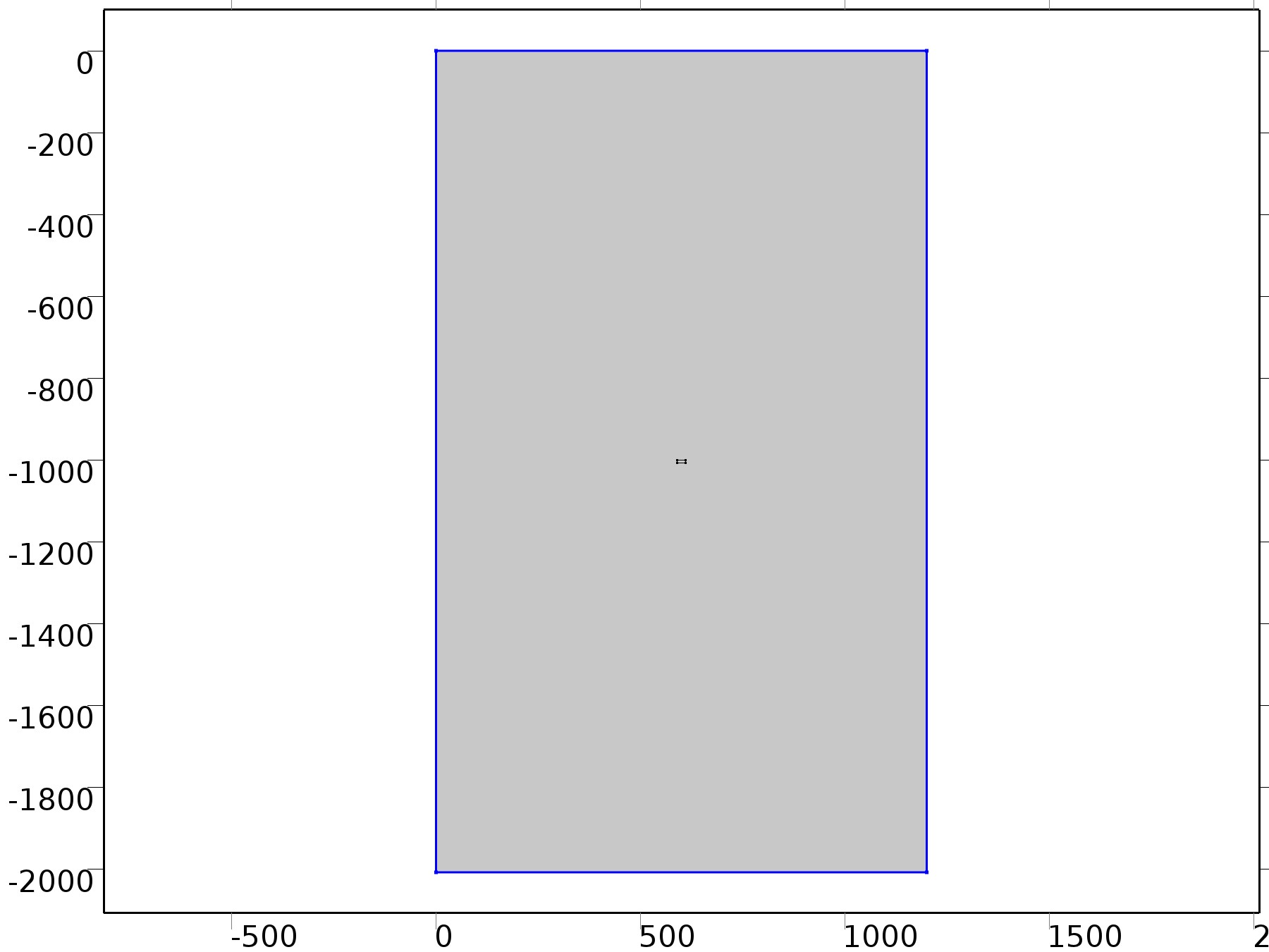

I am currently working on the effects of underground coal gasification on the nearby strata. I have been trying to simulate the same using COMSOL. I made a model consisting of a host rock (1000m x 1200m) and a rectangular cavity (7.5m x 100m) within it, signifying the cavity left after burning of coal.
1. First I made the model having no cavity and allowed it to settle on its own by gravity. The top boundary of the model was kept free and roller were placed on the remaining three boundaries. The total displacement noticed was 15.7 mm downwards.

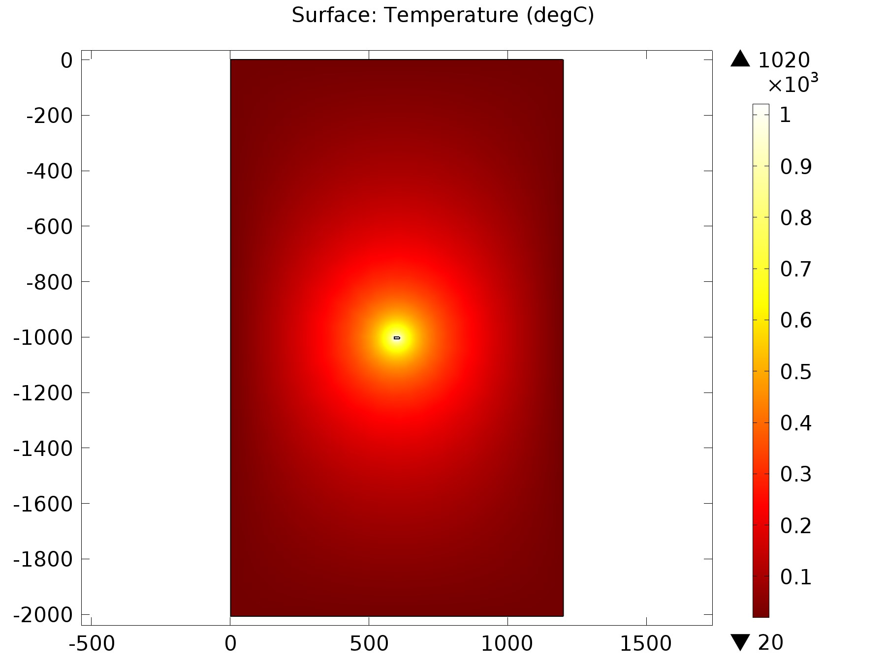

3. Now, to simulate the heating caused by burning of coal, I places four temperature source of 1273.15 K at the boundaries of the cavity.

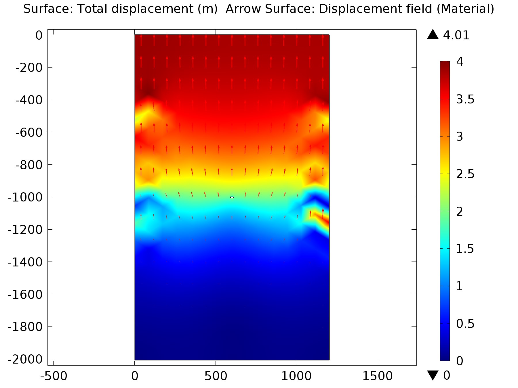

The problem started here as the whole model started behaving like a single body showing thermal expansion. The expansion was visible on the top boundary of the model, as the other three boundaries were simulated with rollers. The total displacement of the top surface is about 750 mm upwards.
I think, the problem lies in the type of heating, the coupling of physics and/ or in the boundary conditions. I have tried every other combination, but nothing seems to work. There is an upheaval on the top surface no matter what.

1. I applied room temperature condition to the external boundaries.
2. The temperature distribution looks fine. As the top boundary is still at room temperature.
3. The reason I am confused is, if the top boundary is at room temperature why is there a upheaval.
I am attaching the pictures and the report created along with this. Please help

I'm not sure about upheaval, but I recommen making the domain wider (maybe 4x) and using symmetric boundary conditions on the left and right. You've got a lot of weirdness going on there. Also I think you'll get insight looking at the trace of the strain tensor (hydrostatic strain).
