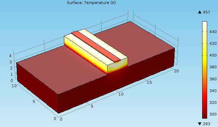

It consists of a copper strip on a piece of GaAs which rests on a heat sink made of copper. A 20 V Voltage terminal will be on the copper strip and the heat flow will be studied through the GaAs and down into the heat sink. The stationary solution is shown in attachment (4), along with the model in attachment (5).

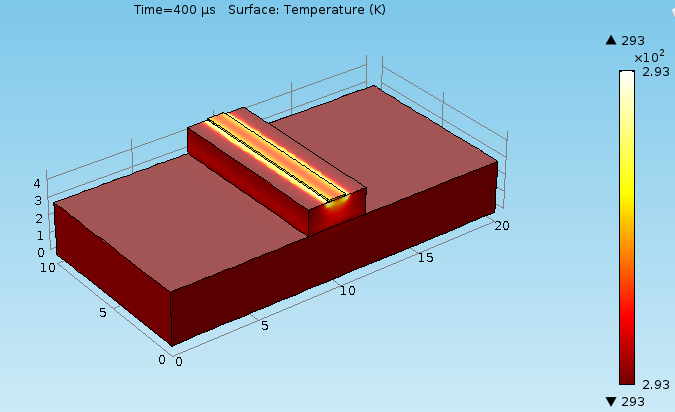

The next step is to look at a time-dependent study, with a 20 V Voltage Pulse, which repeats on a repetition frequency of 10kHz. The variables and parameters are set up, but the solution does not reach a thermal equilibrium in the time specified, and the result is completely wrong (attachment (2)). I am not sure how to rectify this problem, I have tried different ranges of time yet the solution still does not seem to be working.

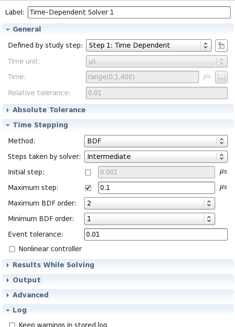

I specified the Time-Dependent node as attached, yet obtained the same result.
My pulse duration is 2us.
Thanks.
Dear Luke, I specified the Time-Dependent node as attached, yet obtained the same result. My pulse duration is 2us. Thanks.

Jonathan,
I tried running the model you attached with the 0.1 um maximum step (as shown in your attached image), and the results looked reasonable to me. The model tracks the pulse shape well and generates heat accordingly. The amount of heating is very small due to the low duty cycle, short run time, and high heat transfer coefficient.
As Walter mentioned, using an explicit event will give you a much shorter runtime than limiting the maximum time step for this model.
Luke Gritter
AltaSim Technologies
[QUOTE] Dear Luke, I specified the Time-Dependent node as attached, yet obtained the same result. My pulse duration is 2us. Thanks. [/QUOTE] Jonathan, I tried running the model you attached with the 0.1 um maximum step (as shown in your attached image), and the results looked reasonable to me. The model tracks the pulse shape well and generates heat accordingly. The amount of heating is very small due to the low duty cycle, short run time, and high heat transfer coefficient. As Walter mentioned, using an explicit event will give you a much shorter runtime than limiting the maximum time step for this model. -- Luke Gritter AltaSim Technologies
