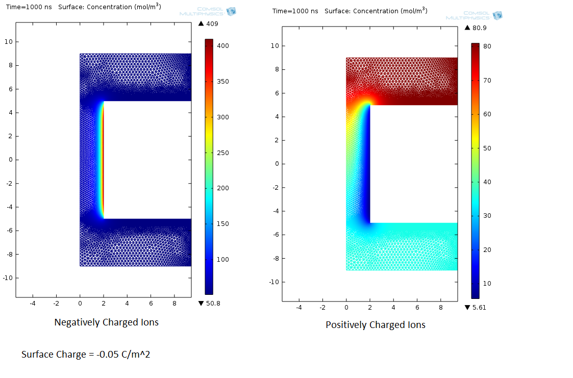

How can I ensure Discrete locations for ions in a nanoscale ion-transport system ?
I'm using the Transport of dilute species module, and have coupled this with the Poission-Boltzmann equation (with Steric accomodations) to model transport of Sodium ions and Cholride ions in a nanotube with a charged wall. I'm getting a rise in concentration of oppositely charged ions at the wall surface, and a corresponding dip for likely charged ions, but this doesn't go to 0 mol/m^3 . Considering the dimensions of the system, I believe I should expect the Likely charged ions to not be present at the wall's surface, as it's physically impossible for both kinds of ions to be present at the same location. How can I ensure this ? Or is my assumption inherently wrong ? I have attached an image that has concentration plots for the ionic species. Please note that I have used an Axisymmetric 2D geometric model.

I understand that the nanochannel resides between two spaces on the bottom and top of your plots. In those volumes electroneutrality does not hold, the conc. of anions is ca. 50 mM and that of cations ca. 35 mM on the bottom and ca. 80 mM on the top. Electroneutrality does not hold in the electrical double layer but that is only a few nanometers thick in those concentrations; you have neither given the geometric dimensions.
To me it looks that the surface is positively charged as anions are accumulating on the wall and cations are repelled - provided that I understood correct where your channel is in the pictures. But whatever is the model, electroneutrality must hold in the bulk of the solution.

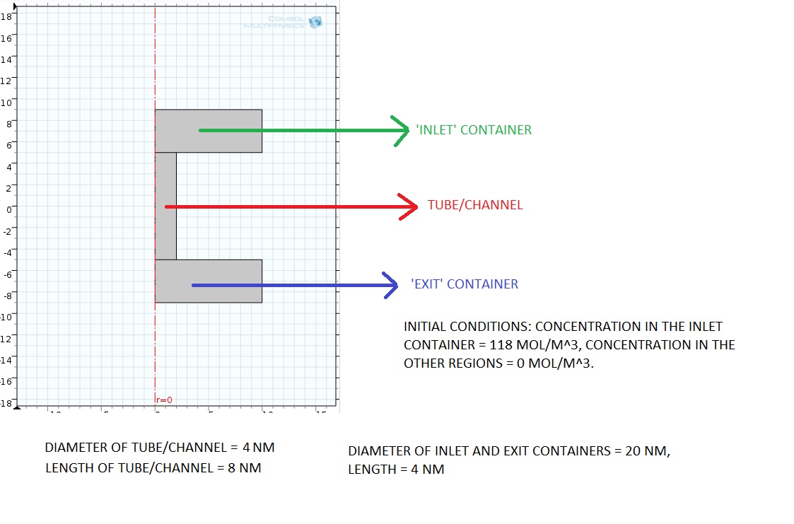

Thank you for your reply ! First, you are right, the surface has a positive charge of 0.05 C/m^2, The diameter of the channel is 4 nm. The Domain is as follows = There is a large bulk concentration of ions in the 'Inlet container', and no concentration in the channel and the other container. The time-dependent behaviour of this is studied. I have attached another picture that has details about the geometry. Again, thank you !

In 0.118 M concentration the Debye length is only ca. 1 nm. Hence I do not believe that your model in entirely correct (neither entirely incorrect :)). Charge density is proportional to the difference of cation and anion concentrations in Poisson-Boltzmann equation. Have you looked at that or the potential distribution? Charge relaxations take place is nanoseconds, i.e. electroneutrality should prevail beyond 1 nm from the surface at all times. And in the inlet and outlet compartment there is no surface charge, hence there is no charge separation. How long does it take to exchange the entire liquid volume? Your plot was at t = 1000 ns.

You have plenty of issues with the units. Also, I would not define variables but global parameters. I suspect that because your units are not matching, the exponential functions are overshooting seriously, giving physically meaningless results.
