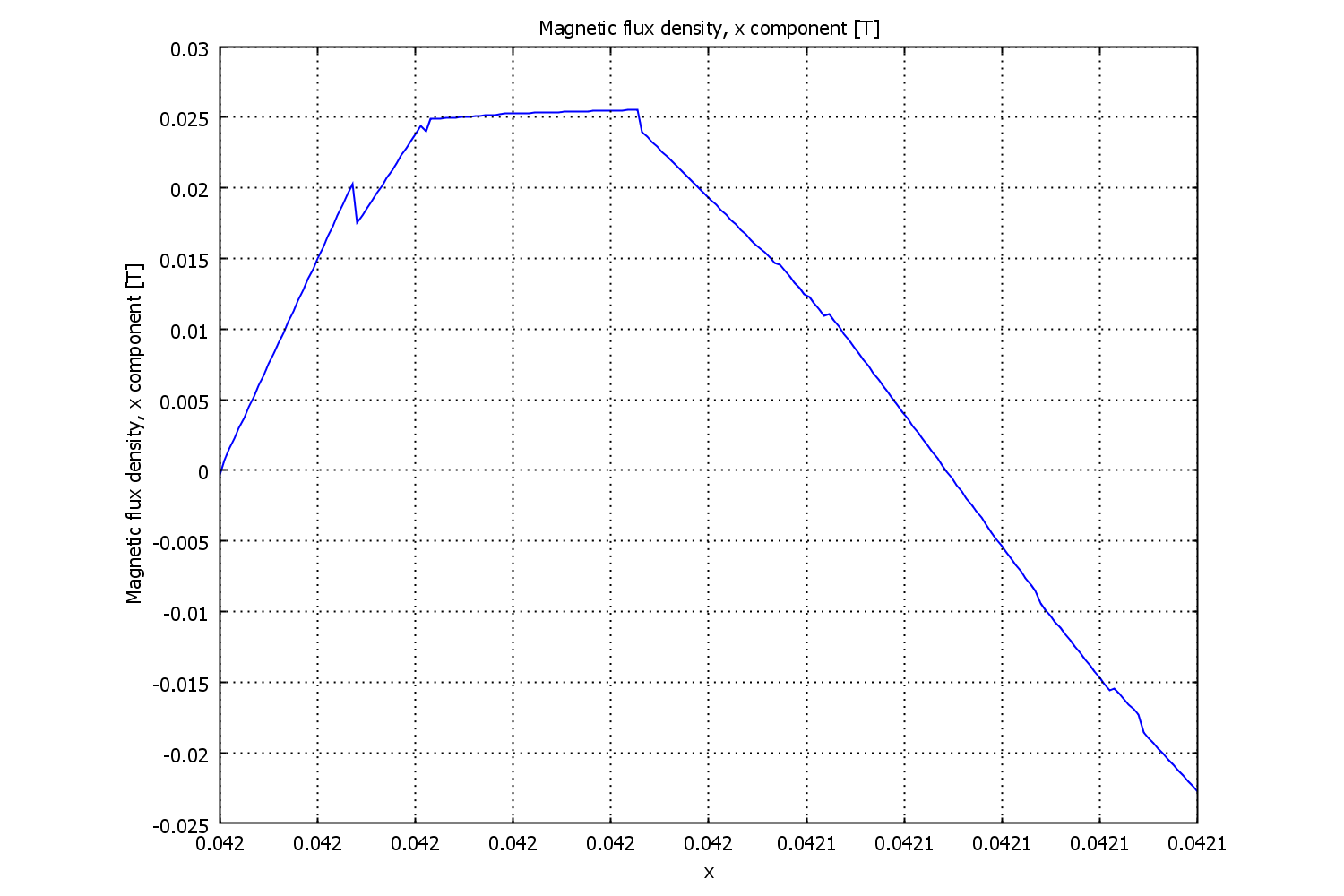

In line/extrusion tab, I choose magnetic flux density, x component, I have a graph that its derivative cannot be zero (attached)

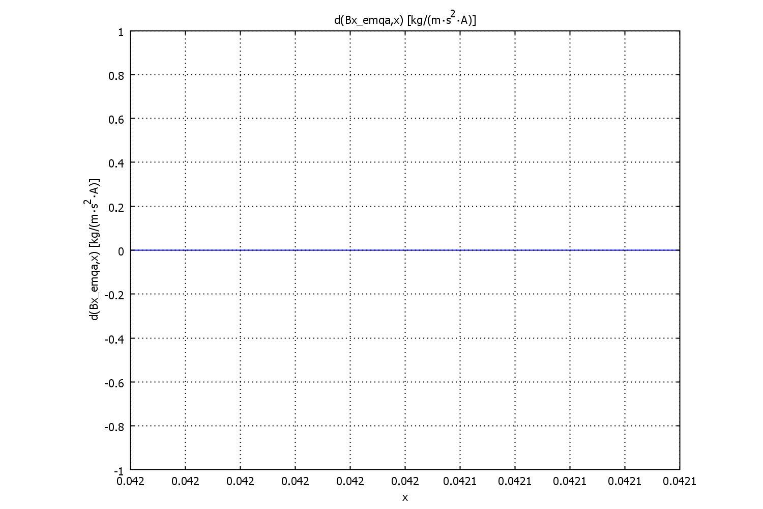

Then I type d(Bx_emqa,x) in expression case, the graph of the result is zero(attached)!
What am I doing wrong? the syntax of derivative in 3D is different than the one in 2D?

I do not have access to my COMSOL running PC, but there are a few things to know abot derivatives: COMSOl can only extract them if the shape functions are of high enough order (2 or more). Then COMSOl has already defined as variables most of the first and second order derivatives. Do not forget that for ACDC you solve for A, the B is then derived from the derivative of A and the gradient of B from the second derivative of A. So if you are looking for the first derivative of the gradient, your are using the third derivative of the dependet variable A, hence you need at least 3rd order shape functions.
I suspect this is the reason why you get only "0". the > 2nd derivative of a second ordr equation is "0" so mathemataically it is correct ;)

The cause of the issue is that 3D electromagnetic models in COMSOL are
solved using vector (curl) elements. In contrast to Lagrange elements used
for other physics interfaces, second derivatives are not at all defined on
vector elements. This is the reason that spatial gradients of B, H and J -
which are all related to the first derivative of the magnetic vector
potential A being the independent (solution) variable - cannot be
visualized directly within the AC/DC Module.
There's a really simple solution to it:
You just have to map the variable you want to derive onto another one defined on Lagrange elements.
You even get a bonus: polynomial patch recovery for smoother plots is available then.
Details attached.
It worked for me right away. Thank you support. I wonder why this is not in KB.
