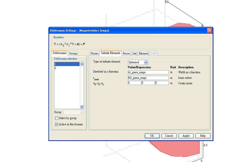

Posted: 2 decades ago 6 lug 2010, 20:54 GMT-4
Hi, onur, I just used V4.0 and V3.5a, so I don't know the conditions of V3.4 . In V3.5a, I think you can open the Model Library ->AC/DC module->Tutorial model->coil infinite elements file and its documentation for details. Moreover, check the Physics menu, choose subdomain settings, and you can find the Infinite Elements category. Hope this can help you~ (See the attachment)
Hanc
Hi, onur, I just used V4.0 and V3.5a, so I don't know the conditions of V3.4 . In V3.5a, I think you can open the Model Library ->AC/DC module->Tutorial model->coil infinite elements file and its documentation for details. Moreover, check the Physics menu, choose subdomain settings, and you can find the Infinite Elements category. Hope this can help you~ (See the attachment) Hanc
