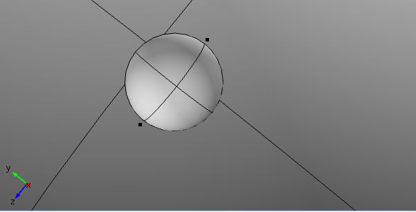

I want to add 2 electric field sources around sphere. I used 2 electric point dipole in 3D around it on the same axis(z).
1- I determine 2 physical points and then linking between them and dipoles.
2- After that I choose the dipole moment option and I get 3 data entries for x, y and z, I know that these values determine the polarization of dipole moment and according to these values the power will be perpendicular to the polarization direction.
My first question is how can I determine the polarization direction and the physical points play a role in that.
The second: how could I convert from [A.m] unit to electron volt.
The attached pic is my structure and it is radio frequency model
Thanks in advance
Dear Sir, I hope every thing is fine with you. I want to add 2 electric field sources around sphere. I used 2 electric point dipole in 3D around it on the same axis(z). 1- I determine 2 physical points and then linking between them and dipoles. 2- After that I choose the dipole moment option and I get 3 data entries for x, y and z, I know that these values determine the polarization of dipole moment and according to these values the power will be perpendicular to the polarization direction. My first question is how can I determine the polarization direction and the physical points play a role in that. The second: how could I convert from [A.m] unit to electron volt. The attached pic is my structure and it is radio frequency model Thanks in advance

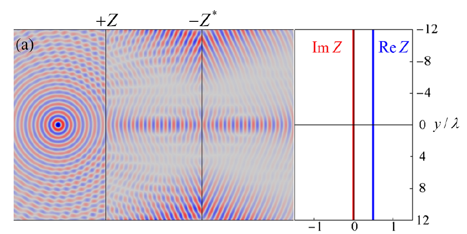

I am working on SPP wave excitation on graphene 2D in COMSOL. I modeled graphene in COMSOL to excite SPP using a point source, I used a circle above graphene surface as a point source. Well, I am interested in TM mode so I used electric field on circle with only x and y components and z is zero. Let me say, if I use Electric field on circle with E0 having components as x=1 [V/m], y=1[V/m] and z=0. After running simulation I saw SPP excited.
I also know that SPP on graphene can also be excited using a port connected to the graphene sheet where we can give port input power=1[W] etc. But in my case I am using excitation using a point source (circle) above graphene which radiate electric field on x and y axis and it excite SPP on graphene sheet which is 20nm below point source (circle). But now I am looking to know the power level I have used for excitation using this method.
Can you guide me how to know the input power I used with given x=1 [V/m], y=1[V/m] and z=0 of Electric field components of the excitation source (ie circle above graphene)?. Do we need to convert x[1 V/m], and y in [1 V/m] to power in watts or current in ampere ? Any suggestions please ?
