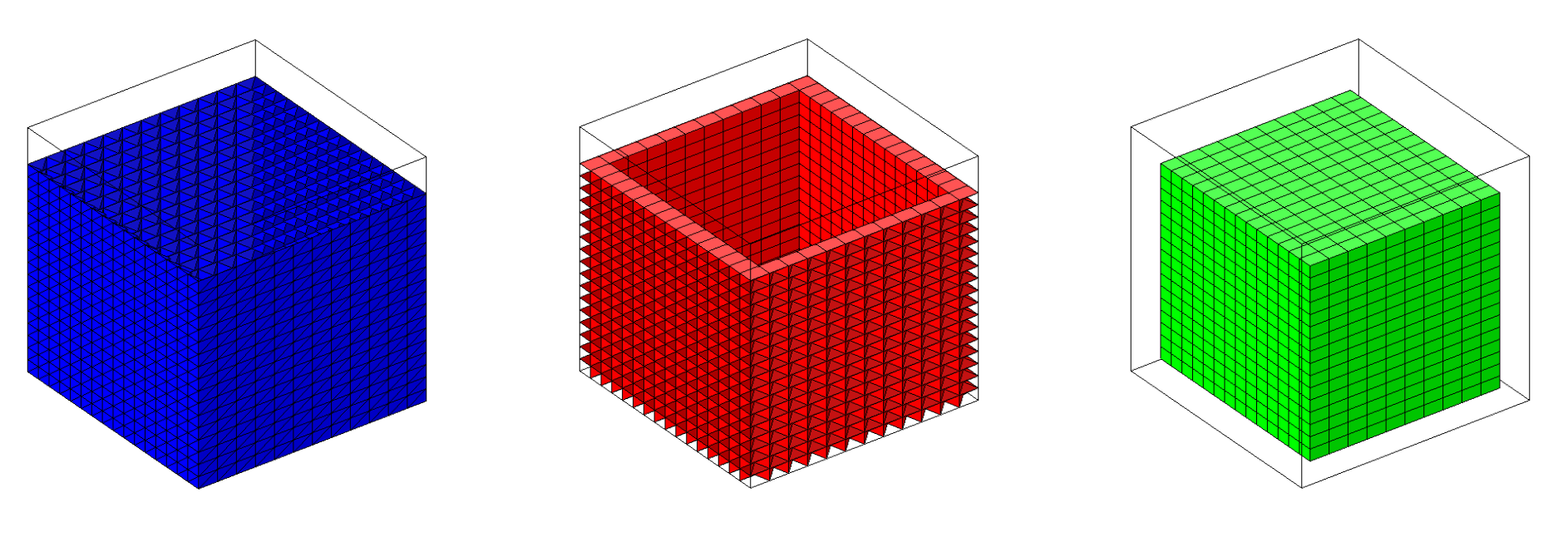

I still don't know how to do it, but I'm pretty sure it is feasible. I'm interested in the kind of mesh that is presented in the picture attached to this reply. You can see that the outer elements are tetrahedrons (blue), the inner elements are hexahedrons (green) and the interface between them is made out of pyramids (red).
I made this mesh by meshing all sides of a block with Mapped. Then I've Swept the mesh inside and converted the boundary of the volume with Convert (adding a diagonal). Unfortunately, I can't control the volume of the inner hexahedrons... or can I?
I still don't know how to do it, but I'm pretty sure it is feasible. I'm interested in the kind of mesh that is presented in the picture attached to this reply. You can see that the outer elements are tetrahedrons (blue), the inner elements are hexahedrons (green) and the interface between them is made out of pyramids (red). I made this mesh by meshing all sides of a block with Mapped. Then I've Swept the mesh inside and converted the boundary of the volume with Convert (adding a diagonal). Unfortunately, I can't control the volume of the inner hexahedrons... or can I?
