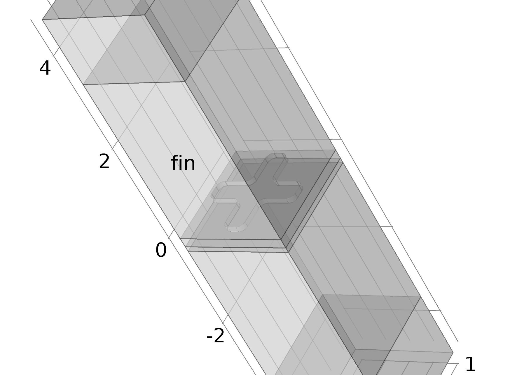

I am trying to simulate the wavelength/ frequency transmission and reflection of a nanoscale cross-dipole antenna on a dielectric substrate.
For this I have taken the approach of the RF module (emw) "Freq Selective Surface with a Split Ring resonator" example as a starting point. Resonance as at 4.6 GHz but I have scaled the frequency up and the geometry down for resonance at around a wavelength 6-10 um. Two ports and S parameters are used to calculate reflection and transmission. Simulations run, but I do not feel very certain about the results
A more suitable approach maybe to use the Wave Optics module (ewfd) ???
Any idea's or comments on this ?
I am not very familiar with COMSOL in RF design and I am using 4.4 at the moment.

It seems that the RF module is most suitable for structures in the same order of magnitude as the wavelength.
Still the results I have , ar not as expected. The COMSOL examples are not really covering my structure (see fig)
I just need to tune the crossdipoles for optimal taransmission at 75 THz.
Probably my definitions of the E-field ( or should I use the H-field ??) are not correct
I have used emw and a wave excitation port : E= 0 (x,z) Ey = exp(-i*k_x*x)*exp(-i*k_y*y) [V/m]
Below the crossdipole is a port without power : E= 0 (x,z) Ey = exp(-i*k_x*x)*exp(-i*k_y*y) [V/m]
and i am plotting Reflection and Transmission emw.S11 and emw.S12.
Wavelength is in the mid-infrared ( 75 THz). Anyone experience with these type of simulations
I'm quite stuck so any help is very welcome
