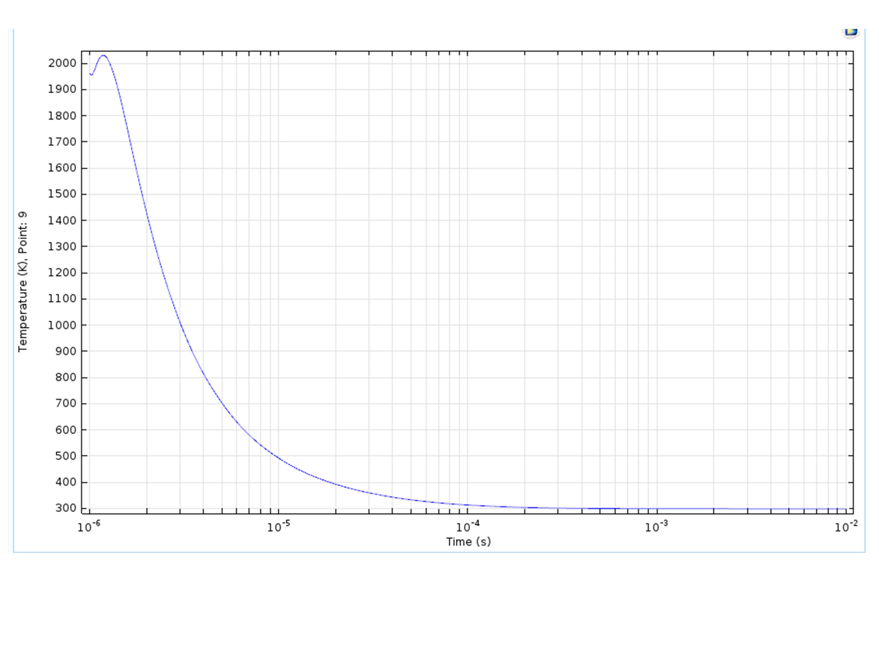

                                                    Heat transfer from the solid to the surrounding fluid is taken into account through Newton's cooling law:
q = h·(Text - T)
where Text is the fluid temperature and T is the solid temperature; h is the heat transfer coefficient which depends on materials. For steel-air boundary it is 5-10 W/(m²·K) and for steel-water boundary 300-400 W/(m²·K). Exact values are impossible to give as they depend on the rate of convection, fouling, etc. But I do not think this value plays an important part, because your solid body is very close to 25 °C at all times, hence hardly no heat transfer takes place.
In Comsol this BC is under Heat Flux --> Convective Heat Flux.
Your plate reaches constant temperature of 25 °C in less than 0.5 ms (see attached image).

                                                    Perfect, thanks for calculation.
is it possible to share the simulation file. I'm interested to see how you define the environment's temperature to be constant at 25 degree.
