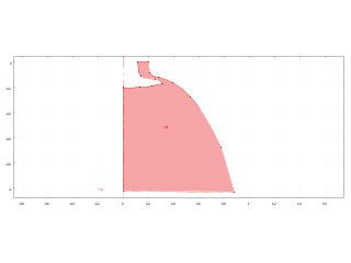

I've a project about an expansion - deflection nozzle. I would like to realize a Comsol model of it. You can see on the pic that it's pretty simple. Just a nozlle with a chamber pressure at the top (102 bar and 2400 K) and a atmosperic pressure for the outlet. I've choose a k-eps model but my calculations never converge !! I don't know what to do. If you can help me.

well you dont provide a lot of info and the attached pic is useless... is it compressible fluid or incompressible for example air water other...
