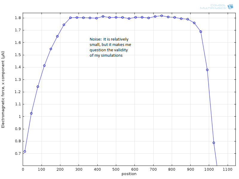

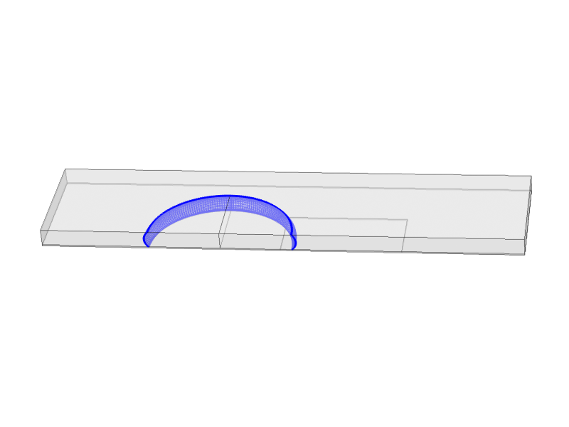

I have been experiencing similar difficulties in Maxwell Stress Tensor Integration. I am simulating the force on a conductive droplet (statically modelled as a solid) in air between two plates at multiple positions (digital microfluidics) and am investigating the horizontal component of the force. I notice some numerical noise in my Force Vs Position graphs (I know analytically that there should not be). It took Ivar's tip and created a uniform swept quad mesh along my surface of interest to help reduce the noise and am using a very fine element setting (~150 000 elements) but the noise only slightly decreases with an increase in element size.
I believe the issue is because the Z component of my force is very large compared to the X component (100x difference). However, I am only interested in the X component and am thinking that this could be creating numerical issues.
Any help on dealing with Z >> X issue would be greatly appreciated and I will make sure to inform the group of my findings as this seems to be a hot topic. I have also tried using both the Force Calculation Node, and manually integrating the X components of the stress tensor over the surface but both have the numerical noise (I am not completely confident that I have done the manual surface integral correctly however).
Happy New Year!!!
Hi, I have been experiencing similar difficulties in Maxwell Stress Tensor Integration. I am simulating the force on a conductive droplet (statically modelled as a solid) in air between two plates at multiple positions (digital microfluidics) and am investigating the horizontal component of the force. I notice some numerical noise in my Force Vs Position graphs (I know analytically that there should not be). It took Ivar's tip and created a uniform swept quad mesh along my surface of interest to help reduce the noise and am using a very fine element setting (~150 000 elements) but the noise only slightly decreases with an increase in element size. I believe the issue is because the Z component of my force is very large compared to the X component (100x difference). However, I am only interested in the X component and am thinking that this could be creating numerical issues. Any help on dealing with Z >> X issue would be greatly appreciated and I will make sure to inform the group of my findings as this seems to be a hot topic. I have also tried using both the Force Calculation Node, and manually integrating the X components of the stress tensor over the surface but both have the numerical noise (I am not completely confident that I have done the manual surface integral correctly however). Happy New Year!!!
