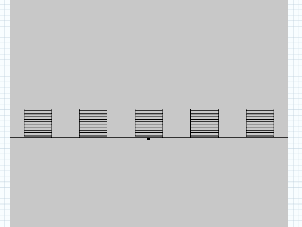

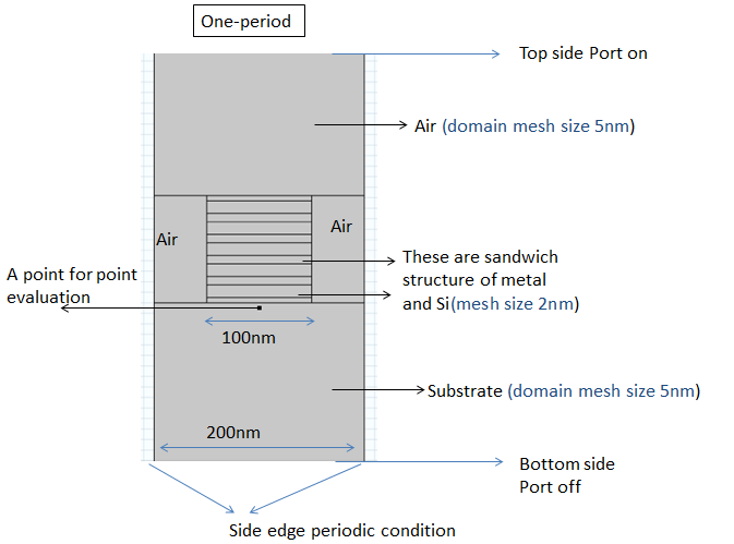

The results turned to be different when a period structure modeled in different structure
Posted 15 gen 2015, 21:37 GMT-5 0 Replies
Both two models have a periodic boundry condition, fot the point evaluation, the simulation results should be the same but the acutally not, hope you could help me?! thanks.
