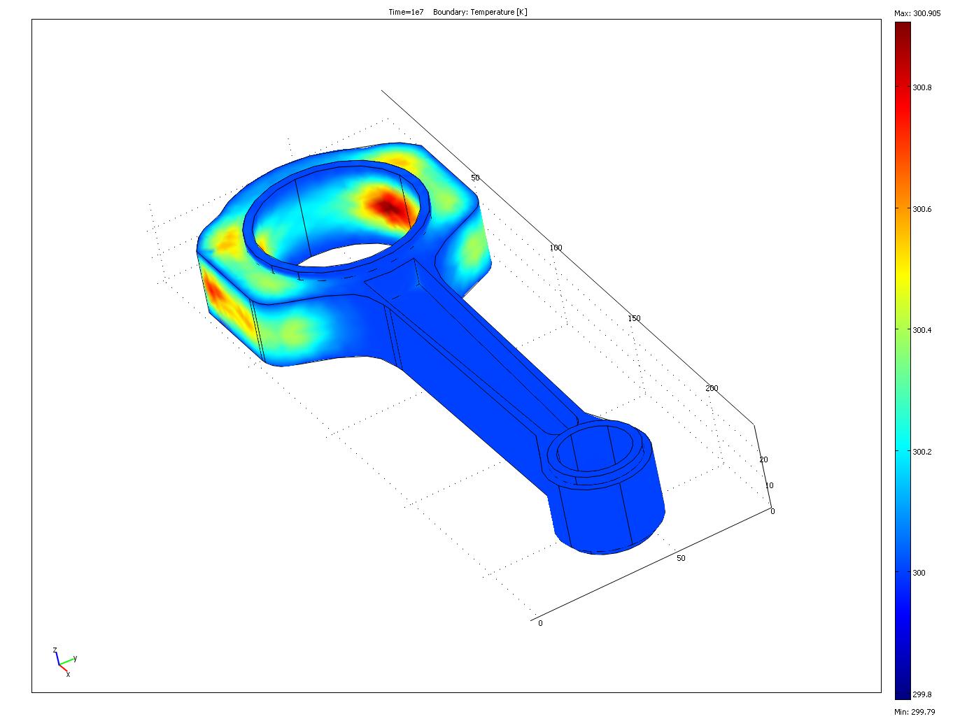

I'm working on a project to model a connecting rod of an internal combustion engine and running into ridiculous data output. I am taking the rod to be at melting temperature and trying to cool it to room temperature.
I have a very simple CAD model of the rod and imported as an STL file.
The sub domain boundary settings were based off of the material library for AISI 4340 Steel.
Q = 0 heat source
d_ts = 1

So after running the simulation, it takes a long time for the model to cool to room temperature. Example would be setting the time to 1*10^7 seconds. The exterior of the rod would be at room temperature, but a slice plot shows certain internal areas to be still at around 1800-2000K. This occurs around the areas where the two large holes are for a connecting rod. Even at lower time intervals, such as 1 hour, the max temperature actually rose higher.
As a test, I ran a simulation for a simple 3-D cube with comsol library material properties for AISI 4340 with constant properties. The plot still shows that the internal temperature is much higher the exterior after running with a large time interval. The cooling time just does not make sense.
Some advice that was given to me was to impose q for the boundary conditions.
As an example of what I am working with, I have attached a temperature distribution of the rod with a time scaling coefficient of 1/60. Note the the time at the top of the graph and temperature scale on the right. I don't have access to comsol at the moment, so I can't get a sliced view.
