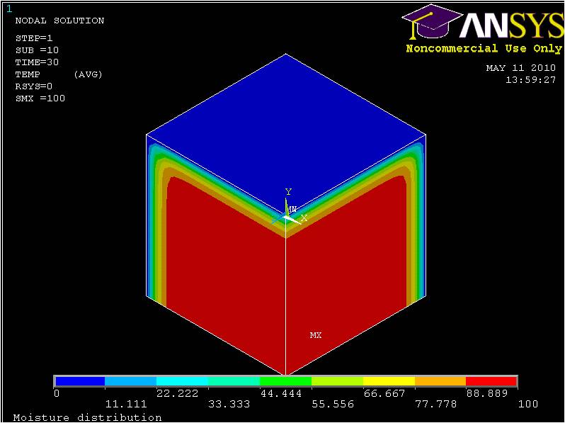

I did the same exact analysis in ANSYS and got the result as expected (temperature distribution within 0 to 100) I have attached the result.
