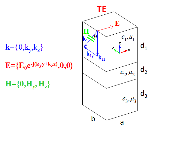

Attached is test model for TE plane wave propagation through glass layer. Model can be easily modified to consider TM plane wave propagation.

You might need to use Beam Envelopes (ewbe) interface available in Wave Optics module if the thickness of glass layer is much larger than wavelength of the incident gamma-ray.
