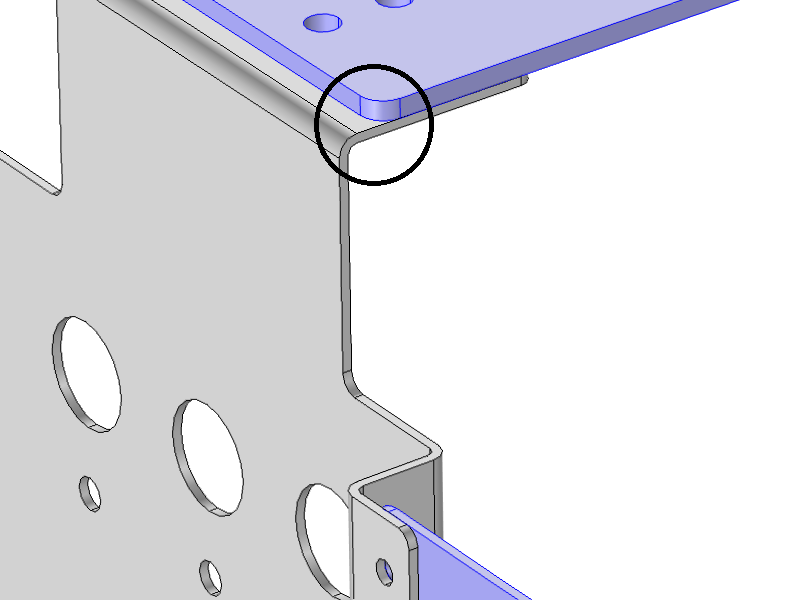

Hi Tony,
You can upload the model and i will try to mesh.
When i mesh this kind of busbars, i usually remove the fillets where the busbars overlap (see the picture). This improves the mesh significantly (at these regions).
Regards
