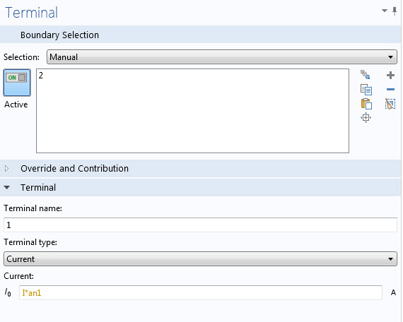

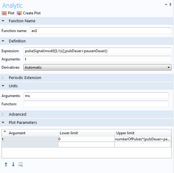

I think I somehow managed to define a periodic signal by combining a rectangle signal and an analytic function.
In order to make use of this signal as an electric current input, I multiplied the analytic function (no units) with my current parameter (25 Amperes). So, under Terminal I have " I*an1 " as applied electric current.

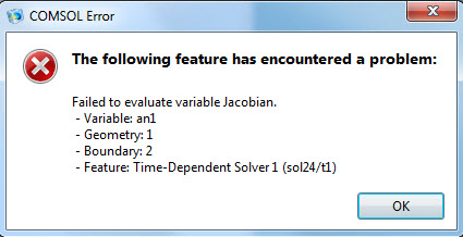

When I try to simulate a time dependent study, I get an error.
I attached 3 screenshots.
What am I doing wrong?
Thank you,
Bartu
