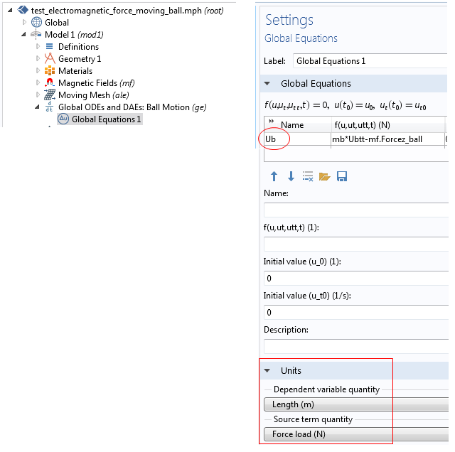

my understanding of the model continues to grow. I noticed that the calculation of the "Global Equations 1 Ub" has the wrong unit.
You use Uz as shift path
* with a constant part: t * 3 [m / s] * 0 ( = 0 [m] )
* plus a dynamic part: Ub (Ub = mb * Ubtt - mf.Forcez_ball
* mb = mass of the ball
* Ubtt = acceleration of Ub (second derivation of Ub)
* mf.Forcez_ball = Force form the Magnetic Fields (mf) which act on the ball in the Z-axis
Ub should have the same unit as Uz [m], right?

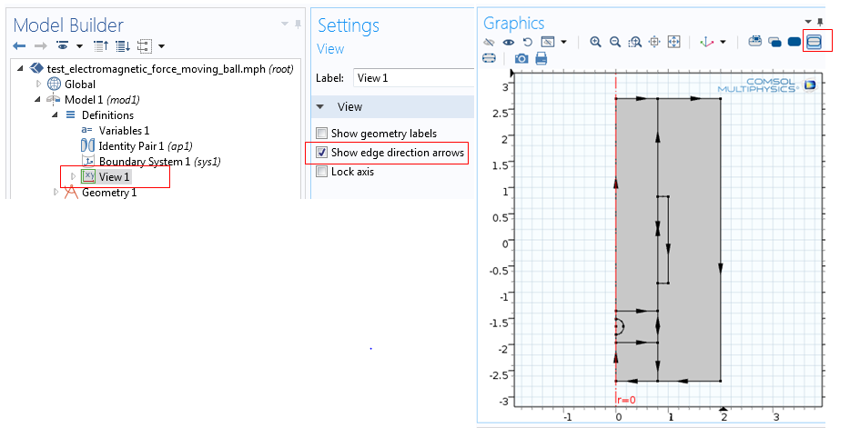

For the Prescribed Mesh Displacement 3 and 4 do you use the variable "s" or "(1-s)", where "s" is determined?

1. The orange color you in the Global Equations settings window is not because the units are wrong but because the units for the global variable “Ub” are not specified at all. If you specify units of length (m) for the Dependent variable quantity Ub and appropriate units for the Source term quantity the color becomes black as shown in the first attached image.
2. Comsol uses internal variable “s” for the Arc length parameter. Parameter s=0 at the beginning of any arc and s=1 at the end of the arc. You can see this by creating 1D Plot Group/Line Graph, then select any edge and type “s” as Expression for the y-Axis Data. Also, you can visualize the direction of edges by checking box “Show edge direction arrows” in the View node, as shown in the second attached image.
Sergei

I think: (@ Definitionen -> Variables1)
Uz = t * 1[m/s] * 0 + Ub
*with the units [m] = [s] * [m/s] * [ ] + [m]
is correct and (@ Global ODEs and DAEs: Ball Motion -> Global Equations 1)
Ub = mb * Ubtt - Mf.Forcez.Ball
*with the units [m] = [kg] * [m/(s^2)] - [N]
unfortunately, this is not correct, Ub should also have the unit [N] ?
But Comsol shows no Error, why? Where did I make a mistake?
With best regards, Thomas

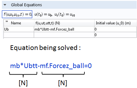

Thomas,
The first column in the setting window for Global equations is the name of the variable being solved for, i.e. you are solving for variable Ub.
The second column is for declaration of the Left Hand Side of equation you are solving, i.e. LHS=mb*Ubtt-mf.Forcez_ball
The actual equation you are solving is as following:
LHS=0
or
mb*Ubtt-mf.Forcez_ball=0
Both terms of this equation have the same units of force [N]. So, units are consistent and correct, see attached image.
Sergei

thanks again. So the actually calculation in Comsol is the formula:
Ubtt = mf.Forcez_ball / mb with de purity [m / s ^ 2]
with mf.Forcez_ball from Magnetic Fields (mF) -> Force Calculation 1
and mb fixed by Parameters: rho_b*v_b = 5.1051E-4kg
and from this the way Ub is determined.
thank you and I wish you a nice day
Thomas
