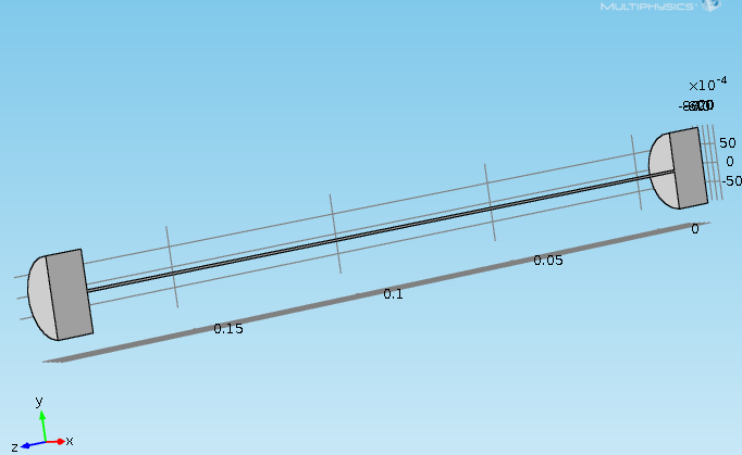

Hi, I am working on a project to simulate fluid speed field in capillary tube. The model could be described as follows:
A capillary tube is insert between two gas chamber, one is at atmosphere pressure, and the other is under roughly 3kPa vaccum. The inner diameter of the tube is 0.6mm, and length is roughly 180mm. I build a geometry model as attached. I used k-epsillon turbulent model to solve my problem. The mesh I choosed is standard.
At first glance the problem is not difficult. But after try different conditions several times, the program still end with error.
Would anyone give me some suggestions on the correct modeling of this problem? Thank you very much.
