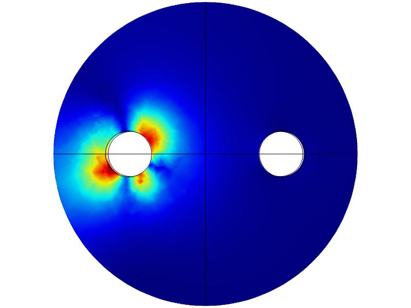

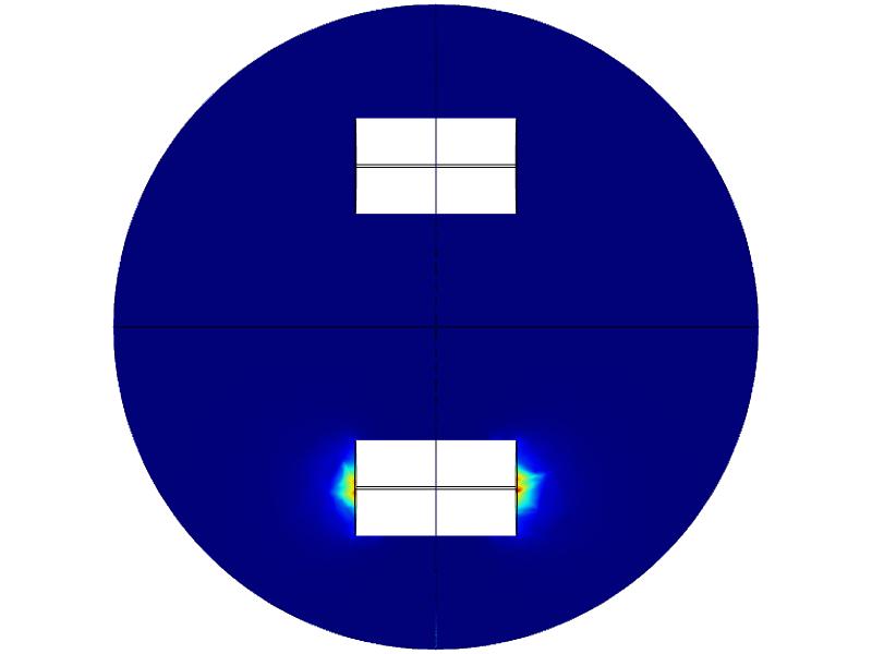

I am a newbie of COMSOL. I am trying to simulate magnetic induction with RF frequency between two metal rods. I am fail to induce a current, Can someone kindly give me some advices? Details are listed below:
I have generated a time-varying current with "frequency domain" study (range (50, 5, 60)), which induces a varying magnetic field. However, there is no induced current on the other rod. I can see there is electric field on the other rod, but no induced current and the corresponed magentic field.
Please find the attached images for more detail.

A quick look at your model shows several severe problems with your boundary conditions.
(1) On one of these rods you have placed lumped coaxial ports. ?? But there is nothing coaxial in your problem.
(2) On the other rod, you have set perfect magnetic conductor (PMC) boundary conditions. That makes no sense either. PMC conditions force the magnetic field lines to be perpendicular to the surface. Why would your cylinder have magnetic field lines perpendicular to its surface?
(3) Even if you fix those two major problems, your external sphere is too small. But then, that's probably the least of the issues here.
After all, it is easy to see that, even after you set the boundary conditions correctly, these will be very-very-electrically-short (i.e., infinitesimal fractions of a wavelength) rods. There is almost no place for any currents launched on them (whether by connection or induction) to actually go (except to induce miniscule levels of surface charges), even if you were to set the boundary conditions properly. This suggests to me that the actual physical problem in which you are interested is very probably something quite different than the geometry you created, but perhaps you thought your geometry was equivalent to it? Real-world systems of currents at such extremely low frequencies (e.g., the 10, 50, or 100 Hz in your model) are normally in the geometry of *closed paths*, not short stubby cylinders. Did you actually mean to have a closed current loop somewhere? Alternatively, did you mean for your cylinders to be *infinitely long*, but decided to make them short just to keep your problem computationally manageable? If so, you should instead be modeling this as two solid circles next to each other in a 2D model, since that would represent infinitely-long cylinders.
I hope that helps. Good luck.
