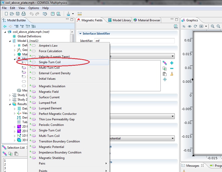

I am following the attached file, under the Magnetic Field Section, it says right click Magnetic Fields and choose domain settings and then Single Turn Coil Domain, I don't see the option anywhere, can you tell me where to find it, even the documentation is not very helpful in this case, screen shots will be really appreciated.
I'm using COMSOL Multiphysics 4.3

Hi Ayush Garg,
Please see the attached screenshot.
Best Regards,
Dima.
