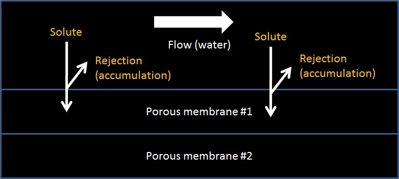

I still didn't fix it at all. Physically, my model didn't simulate the solute accumulation at the free flow/porous membrane interface. I attach an image to clarify what I mean.
I was thinking that probabily i need to manually impose boundary conditions (with form assembly) between the free flow/porous membrane layers, but I'm not sure at all. Probabily it is a mesh issue, but my mesh is very dense. Any suggestions?
Kramer

It is rather impossible to comment without seeing your model. Naturally you need to have, for example, a Brinkman equation in the porous membrane and define boundary conditions for the mass transfer across the mebrane boundaries. But if you attach your model I can comment afresh.
br
Lasse
