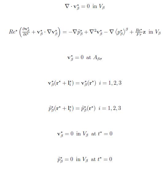

Dear Erik,
I have met the same problem.
If I use the stationary solution as the initial values for the unsteady solver, I would met the same problem as in www.comsol.com/community/forums/general/thread/44477/ and www.comsol.com/community/forums/general/thread/33203/
In addition, I used the periodic boundary conditions, it seems that the definition "steady_state_expression * step1(t)", as has been advised, has no place to put.
Could you please give me some suggestions?
Thank you in advance.
Best Regards,
Bill

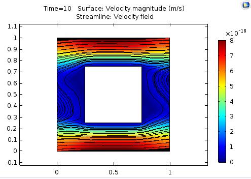

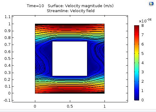

Dear Erik,
Thank you for your reply.
The problems I have met are as follows.
1) Using PDE equations, if I adopted the stationary solutions as the initial values for the time-dependent sovler, the obtained transient results will just the same as the steady ones, even for a very large Re number;
2) I have tried the built-in laminary flow interface. But the results strongly depend on the initial values as shown in the attachment (the initial value for u is 1e-2, 1e-20 separately at Re=10); since I run a large range for Re and the geometry is quite complex, which make it impossible to calculate the initial values at the corresponding Re.
3) As for the "flow past a cylinder" model, it defines a "step1" to trigger the disturbance at the inlet boundary; while I used the periodic boundary conditions, thus the only place to use "step1" is at the initial values setting windows, which will mix the problem (2) about determining the initial values.
Hope to hear from you soon.
Best Regards,
Bill

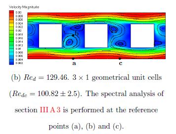

Dear Erik,
Thank you.
I have tried to contact the support, but since I used the PDEs, it is quite difficult for them to find a solution. I am trying to solve the Navier-Stokes equations with the built-in laminary solver instead of using the PDE equations.
I have run the case and the results from the transient solutions seem to be that obtained with a steady solution.
The expected result can be seen in the reference(attachment).
Is there something wrong about my settings? or should I add a perturbation to induce the unsteady flow, as in www.cfd-online.com/Forums/main/135769-time-dependent-solver-unsteady-navier-stokes.html
Would you please have a check?
Thank you.
Best Regards,
Bill
