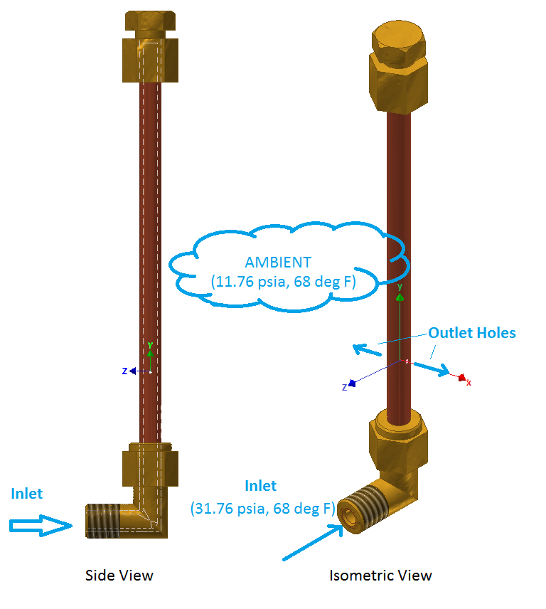

We set up a small copper tube with an internal diameter of 0.160" which has two small holes of about 0.042" diameter in it's side (Sorry for the English units). One end of the tube is attached to the in-house air pressure system at 20 psi and the other end is closed off. The inlet is pressurized to 20 psi in-house pressure- at room temperature of 68*F - and the air flows through the pipe; it escapes through the two small holes drilled in the side of the tube, reaching the ambient environment (11.76 psia, 68*F).
Our experimental results showed the flow was choked within the outlet holes. For clarification of the setup I have attached a .png picture which depicts the study.
