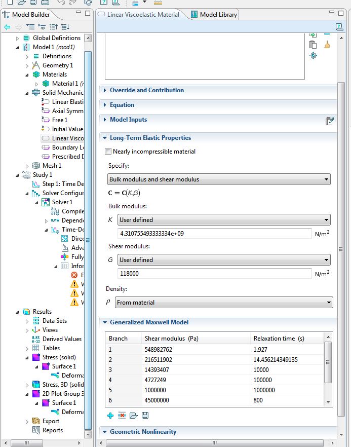

I'm trying to implement my Generalized Maxwell model into COMSOL and I'm not certain how to apply all the parameters correctly. Because when i compare my results to Ansys there is a difference of a factor of 10 in displacement.

However in the section long term elastic properties is it correct to insert Ginf as the shear modulus option and instantaneous bulkmodlus K0 dervied from linear modulus relation:
K0=G0*2*(1+ny)/(3* (1-2*ny))
where
G0=G(0)
ny=poisson's ratio
p1-8= relaxation time Tau
Or should i insert both G0 and K0 in the longterm properties?
I've attached a picture displaying the parameter options for linear viscoelasticity material model.
