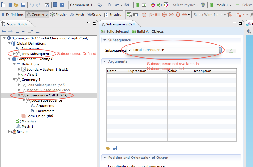

Global subsequence not available in subsequence list
I have made a geometry subsequence in the global definitions but I cannot make it available in subsequence lists in subsequence call nodes. I've attached a screen shot to help illustrate the issue.
Am I doing something wrong? Is this a bug?

Solved my own issue. I was trying to call a 2D sequence in a 3D geometry. The correct procedure is to create a workplane in the 3D geometry and call the 2D sequence from inside the workplane.
