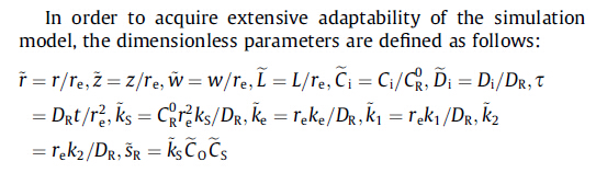

I think it is because i set the diffusion coefficient to small, so i change the unit of my pde,I change all coefficients' unit to 1(you can see it in picture),but in comsol the geometry and physics still have the unit such as [m] and so on, my question is whether it will influence the solution of the pde,will i get the solution i want by inverse transformation.

thanks Ivar! I have a question in transport of the diluted species,when I set the diffusion of the species to 1.77e-9[m^2/s], it is very slow to convergence,and there is a error says"the following feature has encounted a problem: undefined value found -Detail:NaN or Inf found when solving linear system using SOR -Feature:stationary solver1(sol1/s1)" I think it is because i set the diffusion coefficient to small, so i change the unit of my pde,I change all coefficients' unit to 1(you can see it in picture),but in comsol the geometry and physics still have the unit such as [m] and so on, my question is whether it will influence the solution of the pde,will i get the solution i want by inverse transformation. thanks a lot!
