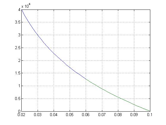

I **should** have something like this:
-- Attached file : Image_analytical

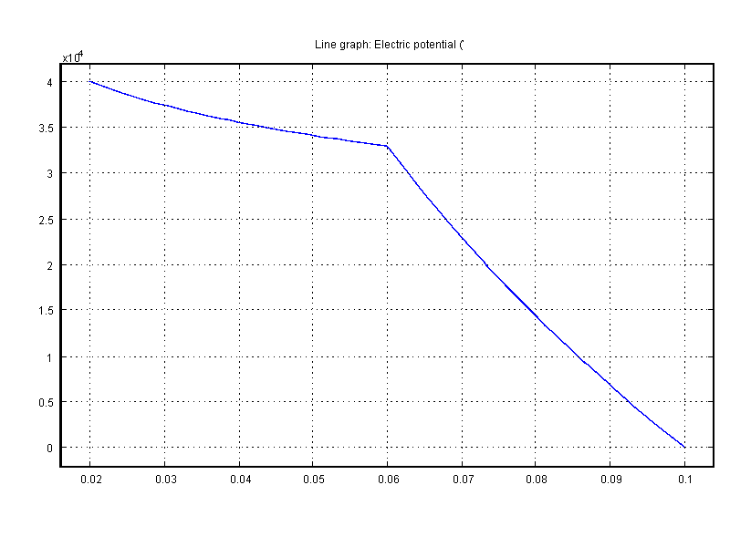

Using this model, or using its counterpoint axi-symmetric 2D model, I keep getting this result:
-- Attached file : Image_comsol
I've tried using Union mode and Assembly mode for creating the geometry, but alas, it's still the same. I've attached all 3 models which basically all give the same result, different than the one I should be getting analytically.
